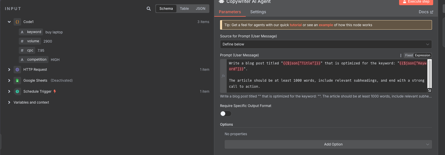

The issue appears to be with the Agent Node, not the Node code.
The variables “Title” and “Keyword” are not present. “Title” does not exist at all, and “Keyword” is written in lowercase (“keyword”) in the Node code.

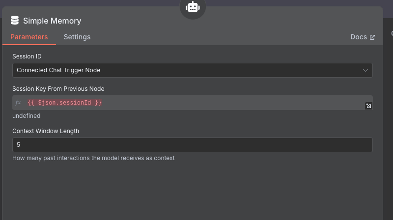

Additionally, the Simple Memory is not functioning because no sessionId is defined.
Recommendation: If you do not need memory, simply remove it.

only the Title is not defined.

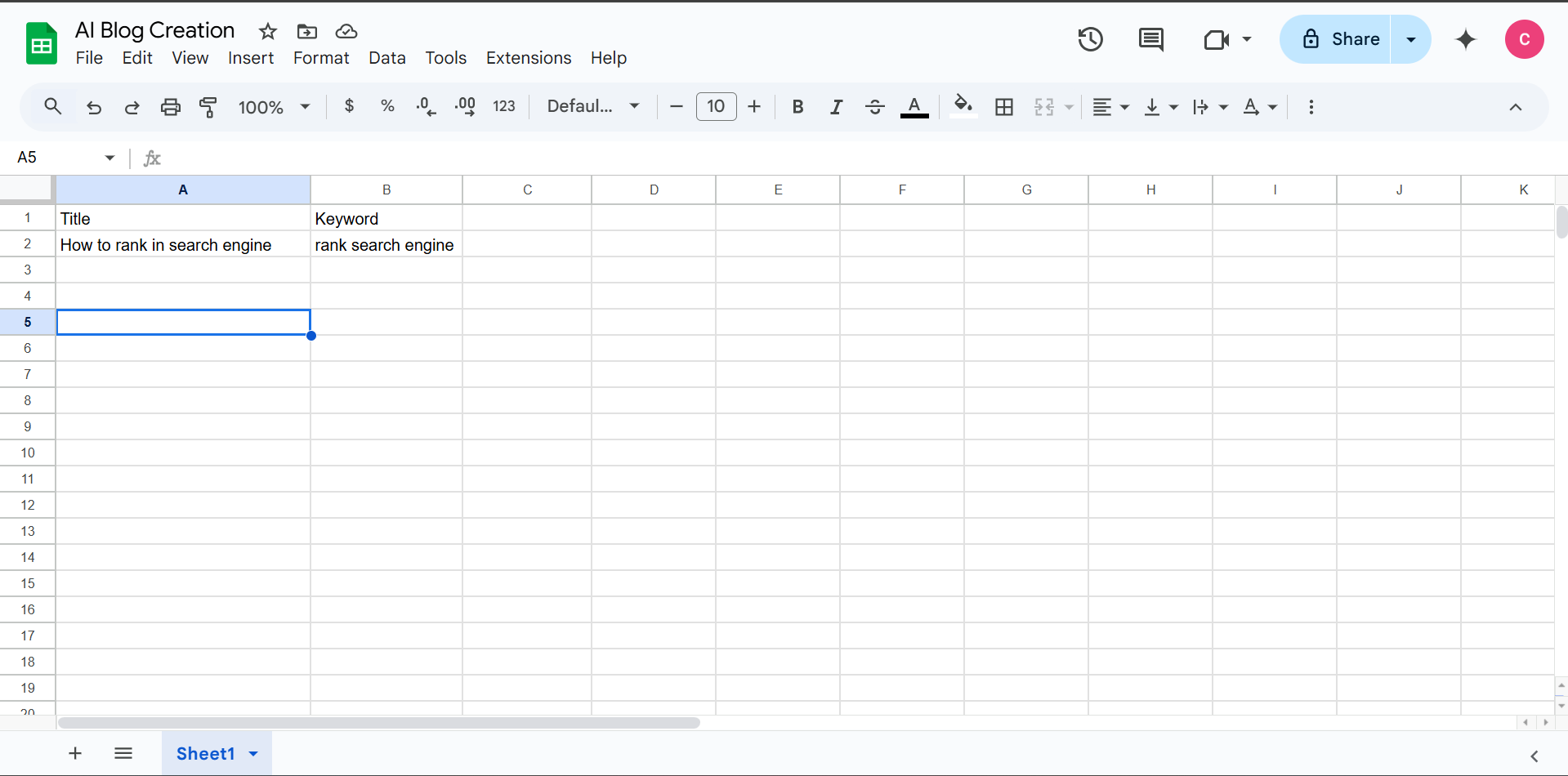

In my Google Sheet node the Title and Keyword were exist. How can I make my variables Title and Keyword to be present? Also I run your example workflow and it runs smoothly but when I tried to connect your example workflow and modify mine and tried to test the Http request node unpin and test, it gets back to the previous null and for the rest of each nodes executed successfully but no outputs.
May you share a few lines of the Google Sheets or pin the data.
The keywords in the HTTP Request node are also hardcoded and not taken from the document.
Without concrete data it’s hard to guess.
Assuming your spreadsheet has a Title and Keyword column. And the Keyword column is a list of comma separated keywords. (= Code node in example)
You can use the keywords from your spreadsheet in your http request with javascript like:
{{ $json.Keyword.split(',').map(item => item.trim()).toJsonString() }}
After that you can Merge with the data from the Spreadsheet node (=Code node in example).
When spliting up the data you can simply check the option to Include All Other Fields.

This is the sample Google Sheets that I’m working. I want the title and keywords from the document will be pass thru the HTTP Request node without a null result or how the results from the task[0] will not be empty.
