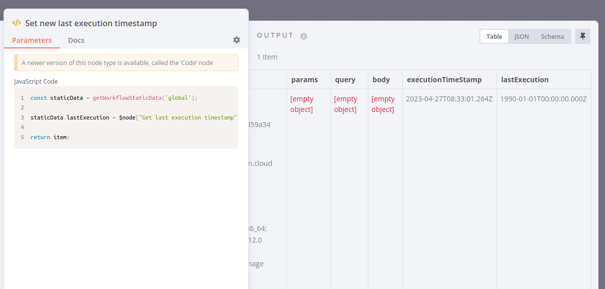

Hi @Gouravdev, both of your Function Item nodes use getWorkflowStaticData('global'); , so I am not sure what exactly you are expecting here tbh and where $getWorkflowStaticData('node') comes into play.
I just tried running your workflow only once (with a webhook trigger, so I can control more easily when it runs) and this is the result:
So the lastExecution value is set as expected for me.
As mentioned, my suggestion here would be to use an external database instead to avoid the confusion coming with static data.
