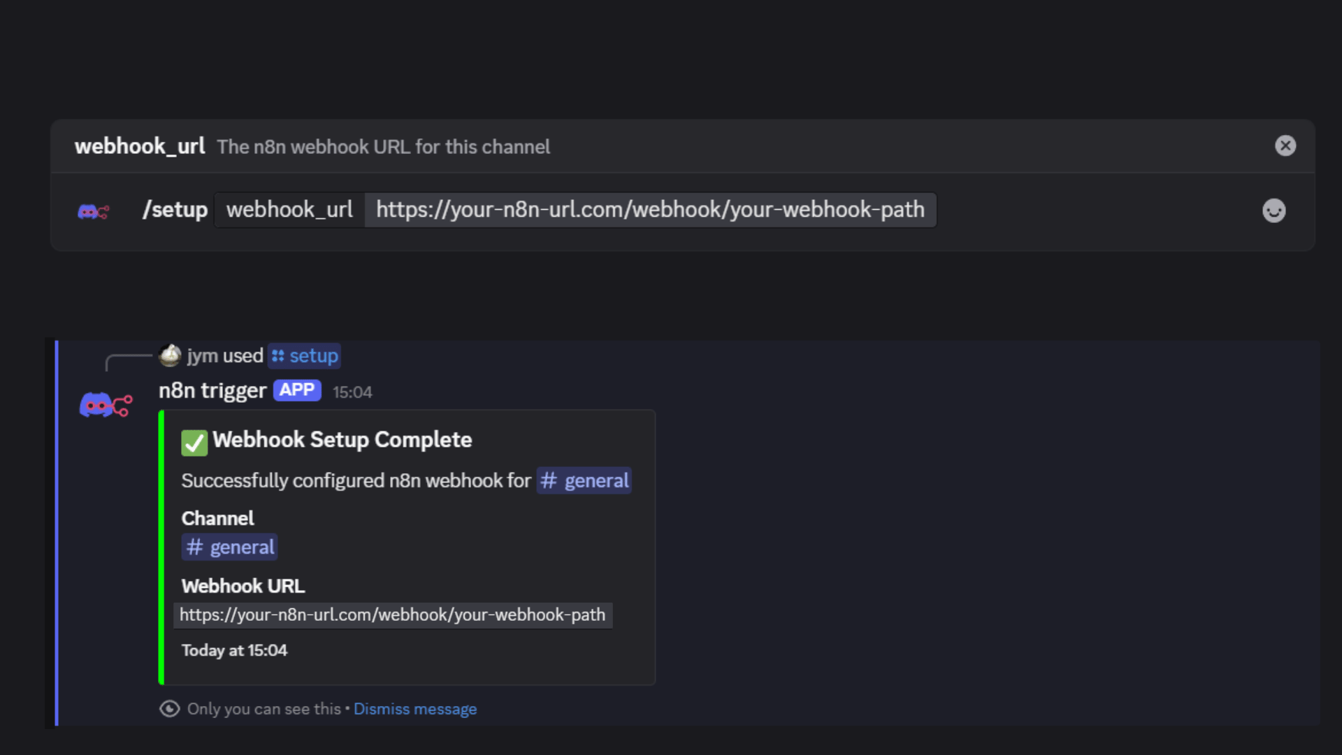

I also had issues with the community node and there seems no workaround for this issue. So I built a discord bot that sends messages to an n8n webhook url whenever there is a new message / reaction / mention sent on the channel where the bot is setup. I call it the n8n discord trigger bot its not a node, so it can work in n8n cloud. It simply sends all new messages in a channel to an n8n webhook once configured.
I made it open source on also on Github so you can read how to use it. If you have any request or ideas, do let me know. You can even deploy it yourself if you want

I had the same kind of issue with Discord trigger nodes, so another way is to skip the trigger node completely and use a webhook instead.
You can use WebhookBridge for the Discord side.
Just create a Webhook node in n8n, copy the Production URL, then in Discord run /connect in the channel you want to monitor and paste that webhook URL.
After that, messages from the channel get sent straight into n8n and can trigger the workflow without relying on the Discord community trigger node.
Might be worth trying if the node is connecting fine but not actually receiving messages.
