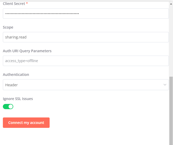

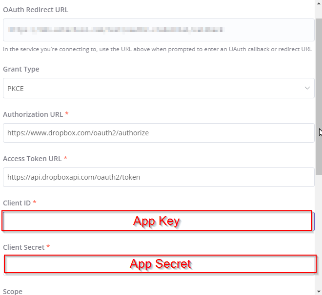

  1. Next set your authentication type to Generic and type to Oauth 2 like so, then click create new, I called mine Dropbox Oauth 2:
    dropboxscopes2
  2. Fill out the information you need using the values below:
  3. Click on the connect my account button, and you will get a permission prompt from Dropbox. Authorize access, then your node should be set after you save the credential.
