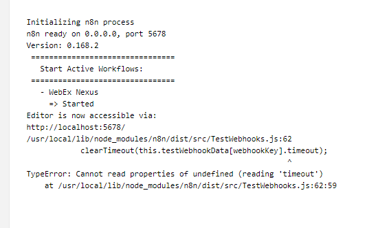

I have to provoke the event, just starting the test flow doesn’t break anything until in the UI it goes from “waiting” to “executing” and then the error from line 162 in packages/cli/src/TestWebhooks.ts fires off.
I’m checking the health of postgres* (not redis, sorry) but it’s hard to diagnose a problem when everything says it’s running fine as far as the daemon/persistent volume are concerned.
Could you share your docker compose file? Of course without any passwords/secrets, just to get an idea how your configuration looks like and hopefully be able to reproduce the problem. TestWebhooks.ts hasn’t been touched since last year, so I am a bit puzzled where this error might come from at the moment.

Hey @dylan.moore, one of our engineers had a look at this but couldn’t see anything obvious here either unfortunately.
The one thinkable situation where errors related to the timeout could occur would be when users clicks to manually execute the workflow (this starts a 2 minutes timer) and then just when the timeout kicks in after these 2 minutes the webhook request comes in (in which case the timeout fires and deletes the webhook).
Now when the webhook node runs it would try and delete the waiting webhook that was just previously deleted by the aforementioned timeout.
So the assumption here is that either your instance is under super heavy load (and this is just a symptom of the problem) or that your database is a major bottleneck.
Perhaps you’d be able to test the behavior on a fresh instance using another database (for example by simply running something like docker run -it --rm --name n8n -p 5678:5678 n8nio/n8n:0.168.2 which would spin up a docker container with the SQLite default database)?
As for the duplicate this does sound like a misconfigured proxy or load balancer.
Fixed it by destroying the database and recreating its volumes. Something in the update must have gotten snagged.
