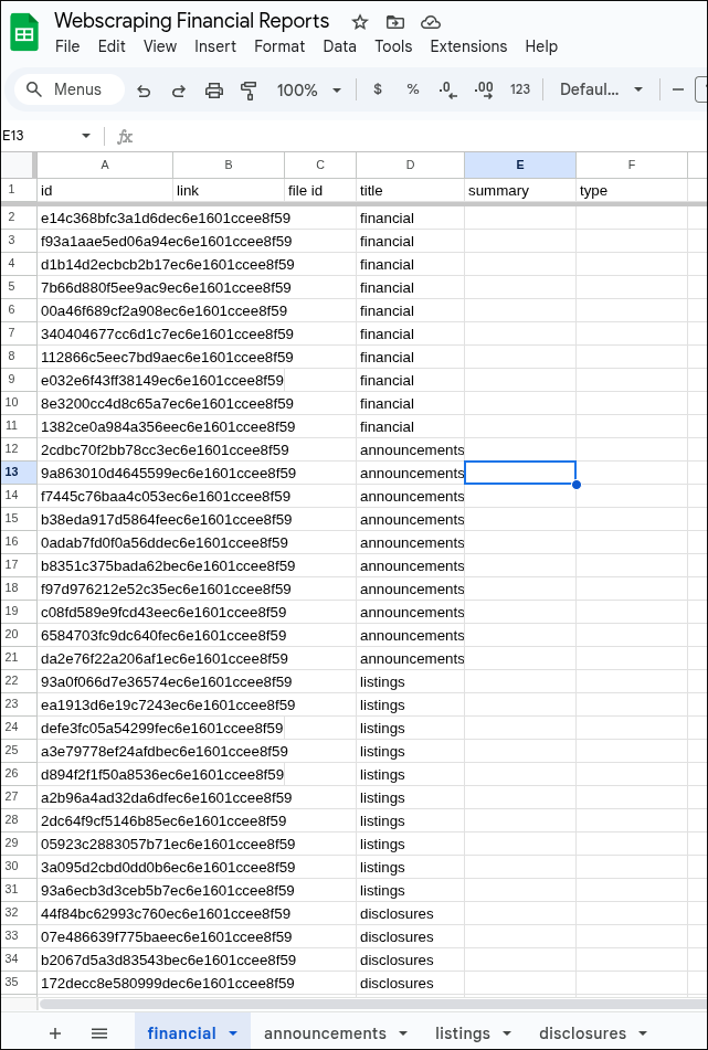

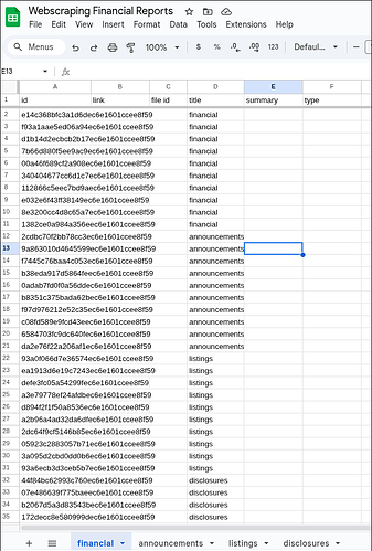

Hello! Im doing some tests regarding the google sheet node and noticed that the node wont work if the expression output is dynamic. It just looks for the first thing that matches and dump all the data in there.
None
"type": "financial",
"title": "title",
"link": "link"
“financial” here is the output of $json.type coming from the code node
and it just dumps all the data in the first sheet it matches eventhough the output $json.type is dynamic as seen in the dump text in the sheet. The other sheets are empty.

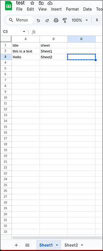

I made a simple project
Trigger outputs an object with the sheet name and content
    "sheet": "Sheet1",
    "title": "this is a text"
    "sheet": "Sheet2",
    "title": "Hello"
Desired output:
Sheet2 contents should be dump in the sheet named Sheet2
Actual output
All dump into sheet 1

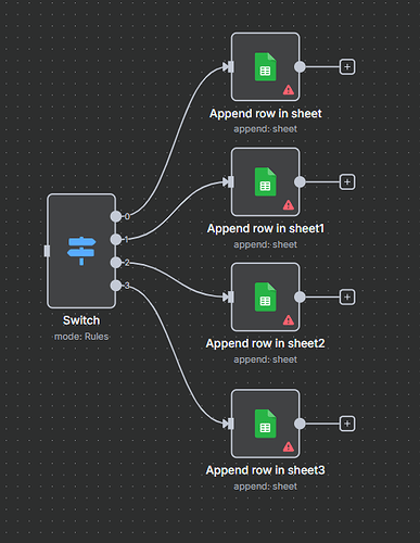

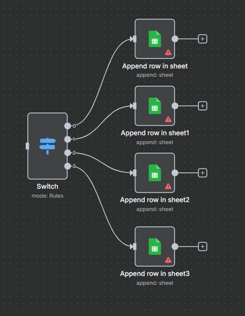

Your main goal is to add rows according to the sheets name, right? Use “Switch” Node. Like an example in below. In this situation, you won’t have to make the sheet name dynamic.
Switch Node example: Financial > output 0 > Your sheets node sheet name: financial
I can’t use the dynamic value for the sheet name?
Its just too repetitive, 4 nodes doing the same thing.
I think it can be used, but I couldn’t fully understand why it didn’t work. Maybe it’s related to the Google Sheets API. It might be necessary to specify which sheet to write to before execution, rather than dynamically. Sorry that i couldn’t help.
