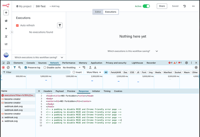

Empty Execution History: getting 403
I am currently in process of self hosting n8n using an Enterprise License.
Have setup different k8s nodes for Main, Worker and Webhook. Have cerated and tested few workflows in test and production mode.
I can see workflow history also. But when I try to see Execution history, I get an empty screen with 403. I am logged in as a Owner user. What is going on here.

Api hit by n8n UI while trying to fetch execution history which is giving 403 is:
https://n8n.integration.mycomp.com/rest/executions?filter={"workflowId"%3A"J6WK8mHCHA0SVJIQ"}&limit=10
But Surprisingly from same broweser if I hit:
I get the list of all the 120+ executions in json body… here is a small response snippet:

I have also updated to latest ver : 1.95.3
But still same behaviour…getting 403 when I try to see any of the execution history: Personal or Project wise

Hello @marcus,
I tried what you asked but still getting 403 Forbidden in browser console while trying to see execution history.
HTTP call is made to : https://n8n.integration.bbb.com/rest/executions?filter={"workflowId"%3A"wcHEPzTpb7ZNdqJa"%2C"projectId"%3A"f7wLdozSB1cYPHY4"}&limit=10
But if I remove the filter query param, then as mentioned earlier i get valid repose from:
https://n8n.integration.bbb.com/rest/executions?limit=10
