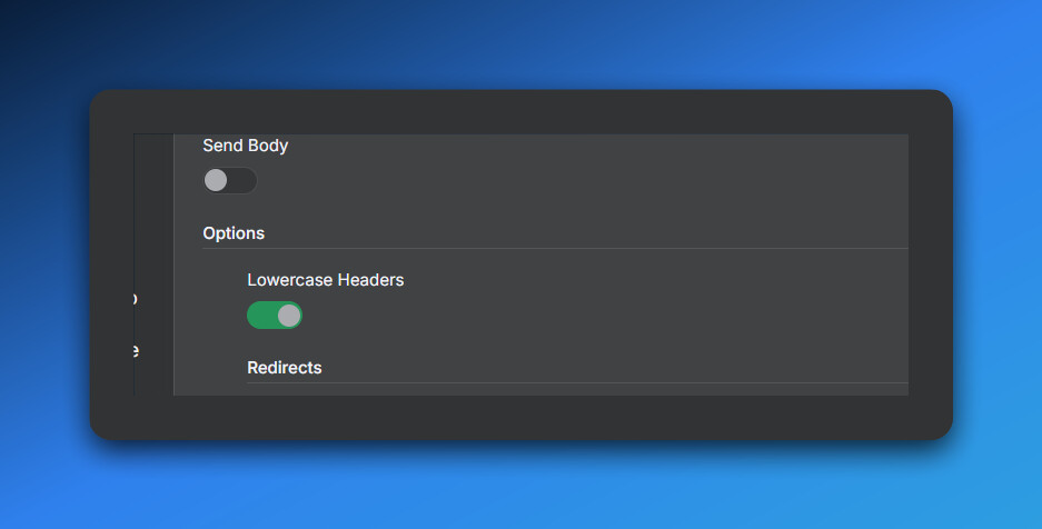

Try disable this lowercase headers in your API Call mit Cookie node
Thanks cutecatcode, the solution is much simpler, and I only noticed it after anonymizing the JSON. The second call only shows “https://dev.”, but it should be “https://development.”, like the login. Sometimes you just can’t see the forest for the trees :wink:
Ah hahahah, ain’t see that too.
