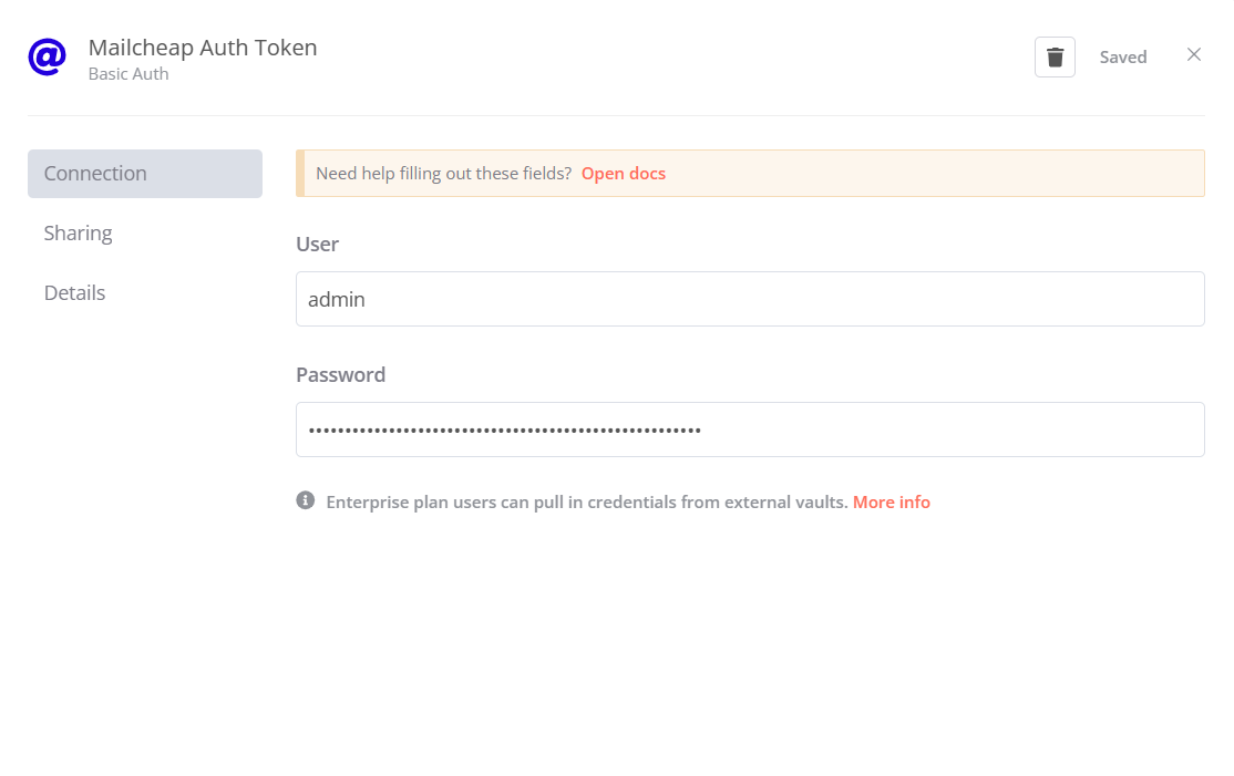

On n8n i used an HTTP Node with Basic Auth:
Tried also using Header Auth
But no success and aways getting the error below.
ERROR: Authorization failed - please check your credentials
401 - “{"error":"Unauthorized","message":"Invalid authorization"}\n”

I have even copied the token from insomnia and set a fixed value on Basic Auth and didn’t work.
Tried the other option on header too, with fixed token also.

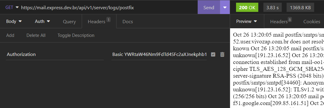

Insomnia with Headers (Working)
n8n with same Header (Not Working)

Hello, guys, I can’t by any reason make this to work, I found the logs on Insomnia and I realized that are some redirects. Can you help me again to check if this can give any direction to solve this issue?
This is the API docs:
Mailcheap API Docs
This printscreen shows all that is included on the request.
This is the logs on the request I made to the endpoint that gives me a 200 response.
