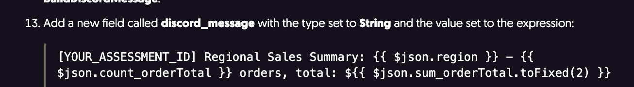

Hi Akarsh,
Update: I’ve just tried the webhook and noticed this issue happens when the text message isn’t in the correct format or the input isn’t the right answer, n8n server will reject and respond like that. Please double-check if your message has a similar format (e.g, square brackets around assessment_id, order of value, commas, currency character, etc.):
[4e98de96b6ca491137acc0efxxxxxxx] Regional Sales Summary: Oceania - 999 orders, total: $9999.99
Instruction from the course:
This error message is quite generic, so I can’t tell exactly what is happening. I just know there’s an issue with the Discord webhook. Could you copy and paste your whole workflow here so we can investigate? Alternatively, you could share a screenshot of your configuration on the Discord node, along with a screenshot of the return data from the node right before it.
嗨,試試在輸入Assessment-id到「BuildDiscordMessage」節點時加上方括號[]。我就是用這種方法讓Discord節點正常運作,訊息也成功送到n8n-quickstart頻道。我也遇到過和你一樣的錯誤。
