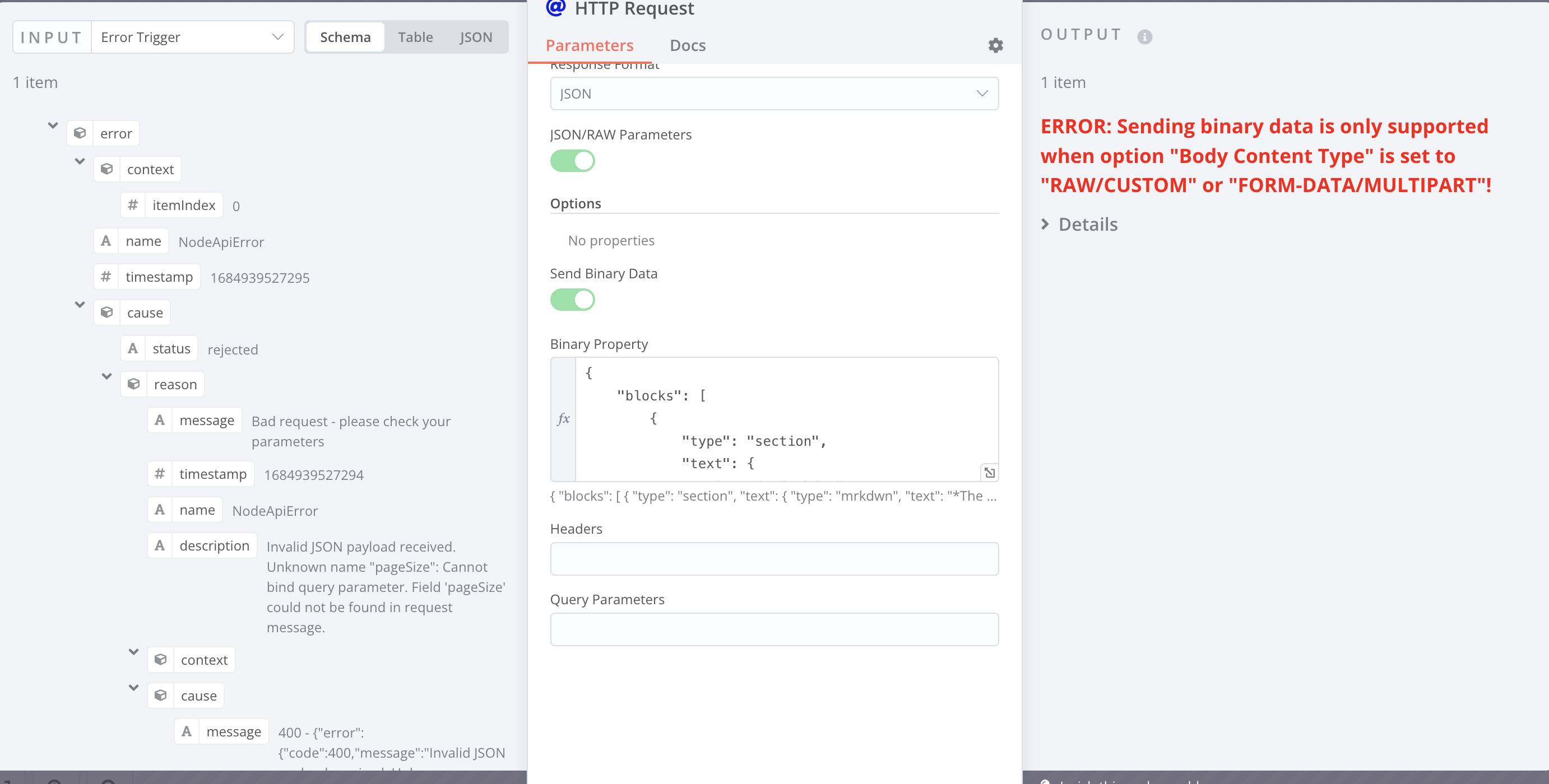

Hi @Jon
I am facing an issue,
ERROR: Sending binary data is only supported when option “Body Content Type” is set to “RAW/CUSTOM” or “FORM-DATA/MULTIPART”!
for
“text”: “Error Message\n”{{ $json.execution.error.description}}“”
or
“text”: “Error Message\n{{ $json[“execution”][“error”][“cause”][“reason”][“description”] }}”
or
Can you please help.
Thanks
also $json[“execution”][“retryOf”]
doesn’t work with auto trigger. If possible please fix it.
