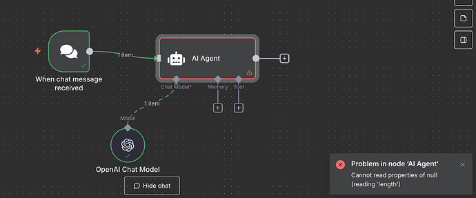

I am creating my first workflow. But getting errors "cannot read properties of null (reading ‘length’).. Seems the OpenAI chat model is providing the output, but the AI agent is seeing some errors. Not able to debug.. Tried various things such as different API keys.. but nothing seems to work.

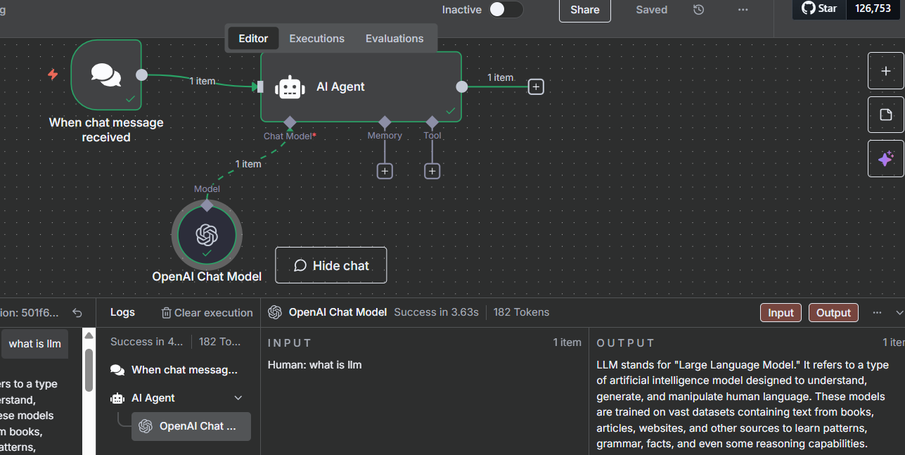

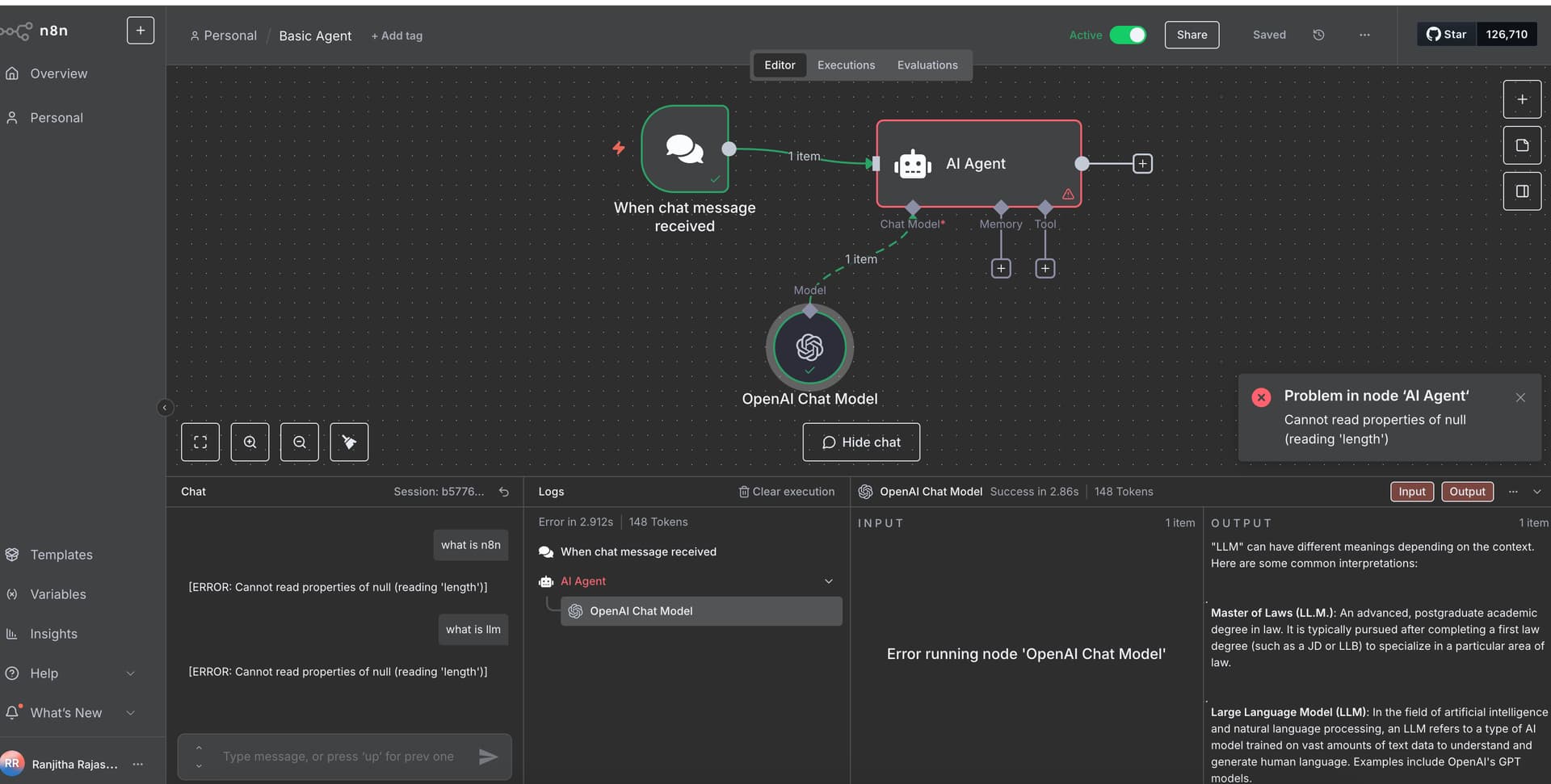

Thanks for the response @rbreen. I took the exact json file you provided, but still the same error. I am thinking something wrong with the environment or I am missing something. Here is the workflow I have.. Nothing fancy, just the basics. This is my first workflow and unfortunately I am stuck.

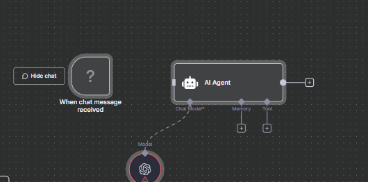

also when i tried copy pasting your workflow it gave me this:
it did not recognized chat trigger node.

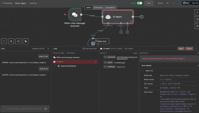

@moosa I think we are close.. what I found out was I have the latest N8N (1.105.2) and it’s creating the agent of typeVersion 2.2.. somehow this agent didnt work. My friend gave me typeVersion 1.8 (exact same code) and it worked. So not sure how I can change the agent version from N8N. Any solution for this? Or should I go back a version in N8N?

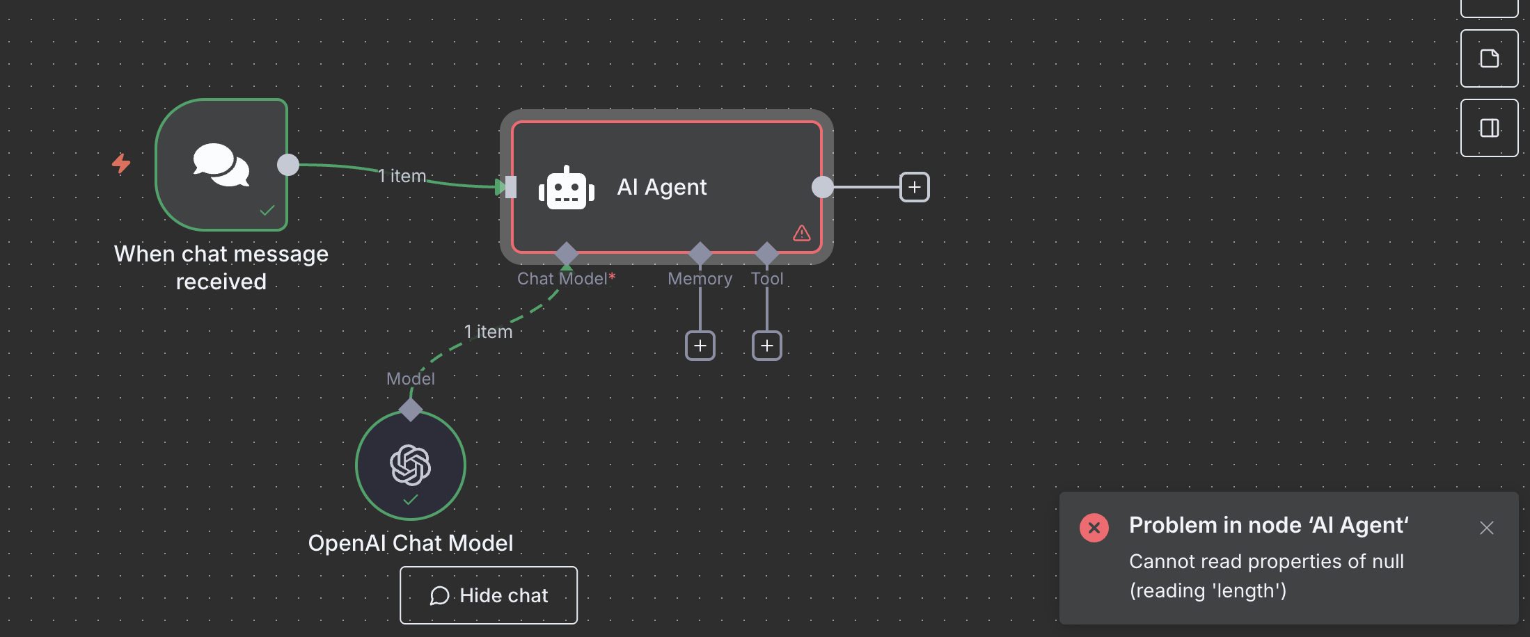

simple flow but it results in the error “Cannot read properties of null (reading ‘length’)” from the agent.
However if I copy the flow, paste it in vscode and override the version of the agent node from 2.1 to 1.8 and paste it back into the n8n canvas, it works just fine.
