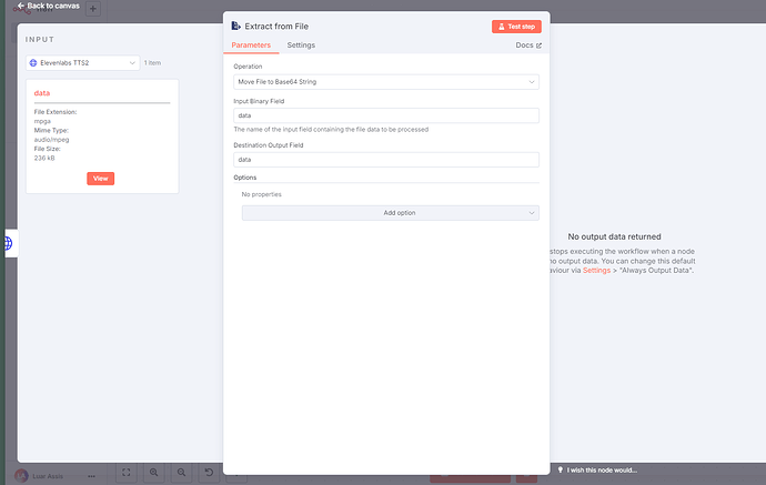

Extract From FIle "Move File to Base 64 String" returning no output

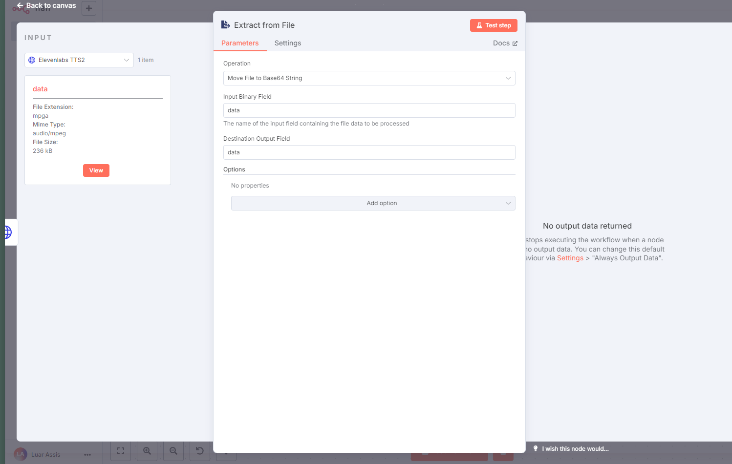

The Extract From FIle node set to Move File to Base 64 String is returning no output at all, I also tried specifying that I want a base64 string in the node settings.
No output data returned
n8n stops executing the workflow when a node has no output data. You can change this default behaviour via Settings > “Always Output Data”.
No output

Hi @Luar_AS,
The node settings look fine to me.
I suspect the ElevenLabs output isn’t a valid file. Did you try testing that output file?

It is, I used it before via telegram send file node, but in order to send via whatsapp I gotta turn into base64

I have no idea what the problem could be, should I open a ticket?
(update) I unpinned all data in the workflow and tested again from scratch, it worked.

That’s very likely because pinned data doesn’t contain binary (a documented peculiarity) and in testing mode the next node receives only what is pinned.
