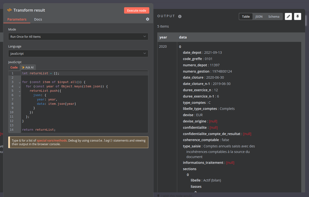

Hi @Joachim_Brindeau, I reckon you want one item per year here? @nico-kow recently shared a possible approach converting columns into rows/items working quite well here. With a little tweaking it can return the data for one year per row, for example like so.
You can then reduce the result further using additional Set nodes. Since there is more than one Montant brut annĂ©e N value for each year it wasn’t quite clear to me what output exactly you’d like to see, but if you can provide an example of what exactly you’re looking for we might be able to help :slight_smile:
That first step was exactly what I am looking for!
Thanks a lot, I’ll put that in place!
