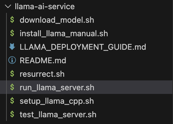

my LLM deployment method
the content in run_llama_server.sh

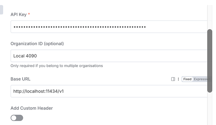

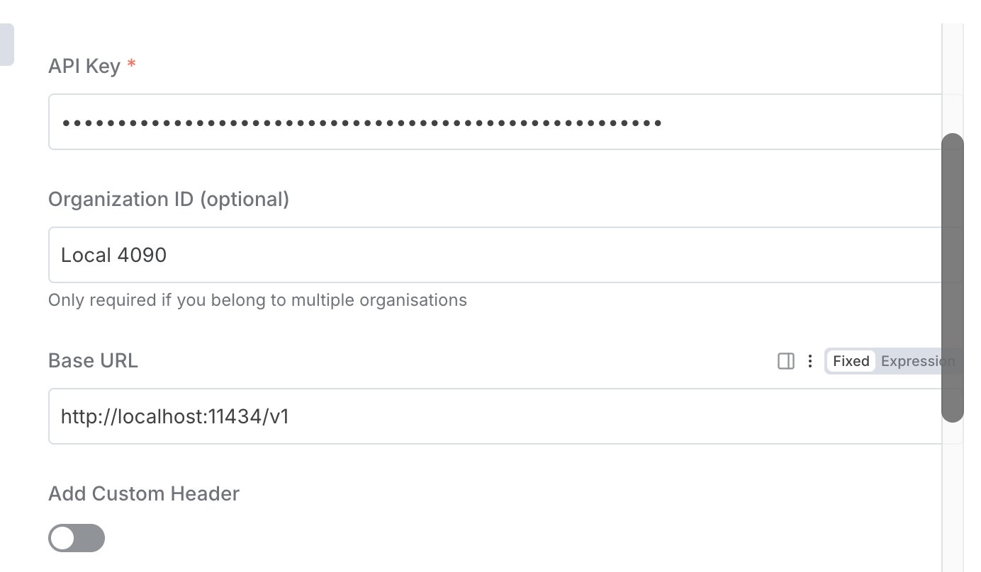

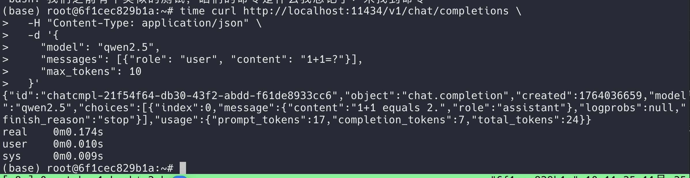

In the OpenAI credentials for the model node, you can set the base url (with or without v1) and call the model. You can see in the screenshot, in the terminal, there’s requests with both v1 and without.
think you very much 。today i try again ,it works,it‘s amazing 。
