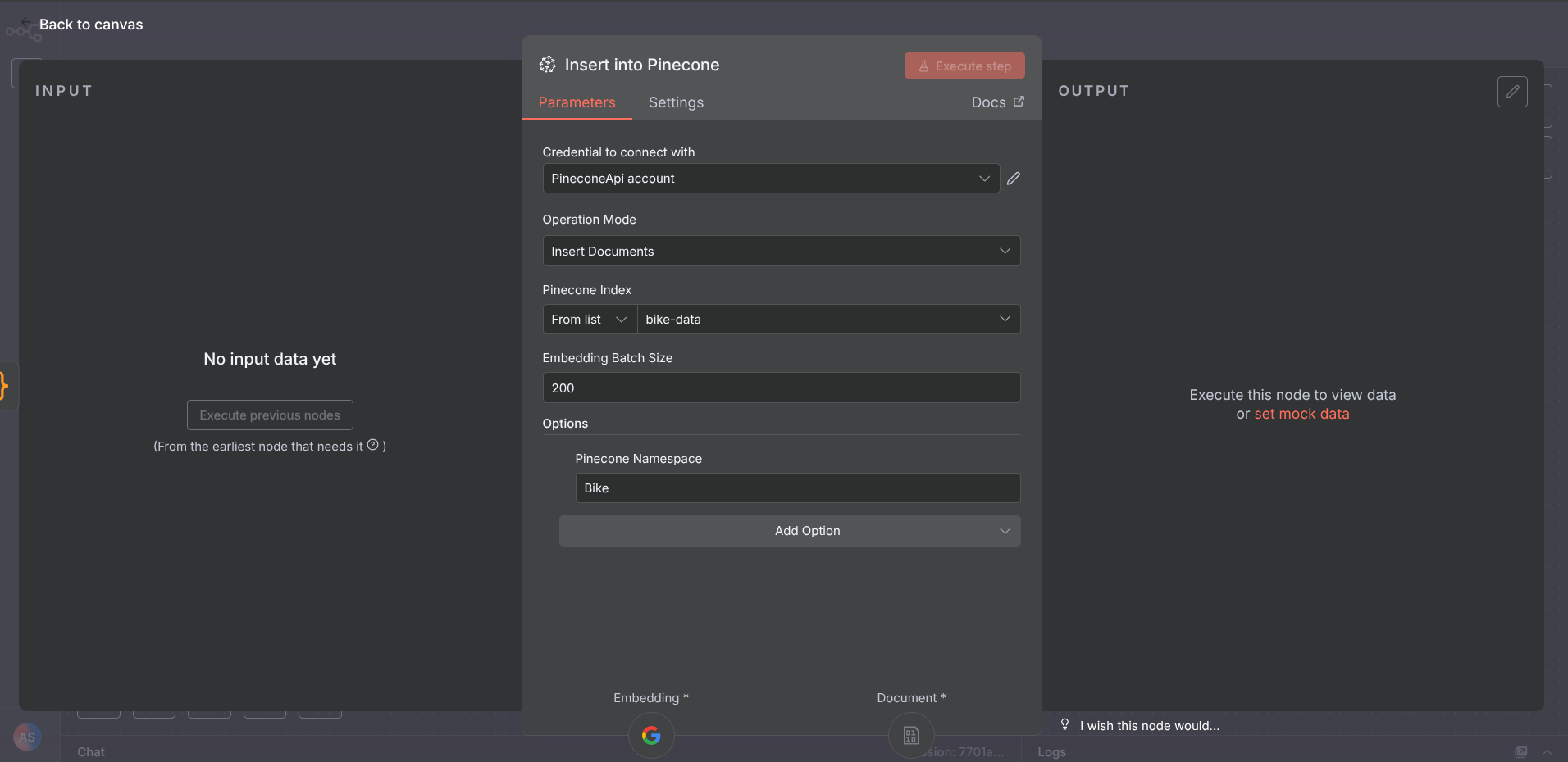

The idea is:
The Pinecone vector store should have a “set custom ID” as an option to be presented while inserting data to Pinecone. Currently it doesn’t have one. It sets ID automatically but I want my own Custom IDs to get inserted.
It would be extremely helpful when it comes to updating a particular vector data, in a situation when you have a second data store like a “google sheet trigger”.
For example, if you have an inventory in Google sheets and want to sync it live with Vector Database then you must match the Google Sheet ID with Vector Database ID, only then you can update/delete rows from both places at the same time.
Currently we do have upsert with ID but the problem is, while inserting we should be able to add our own IDs from a second source (like Google sheets). Otherwise how could we know what ID belongs to who?
