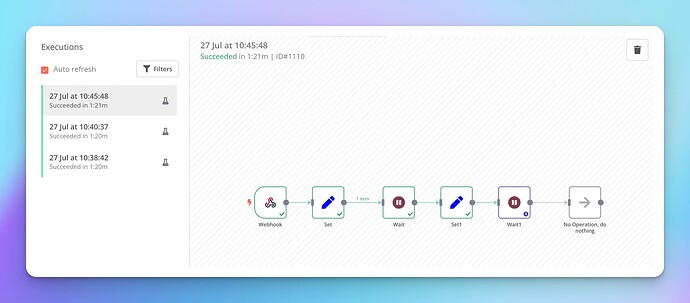

I’ve ran this workflow a few times and haven’t had any issues with it completing after the second wait node:

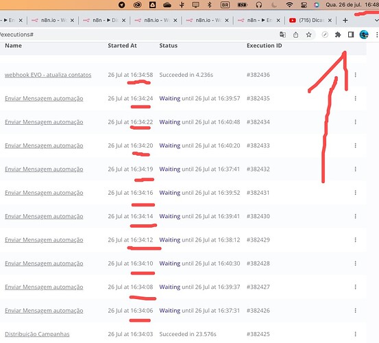

Thank you very much for the answer, it helped me to solve it here, I just added the GENERIC_TIMEZONE parameter to my stack.
but the other day wait failed again, what can i do to help you identify the bug?
but the other day wait failed again, what can i do to help you identify the bug??

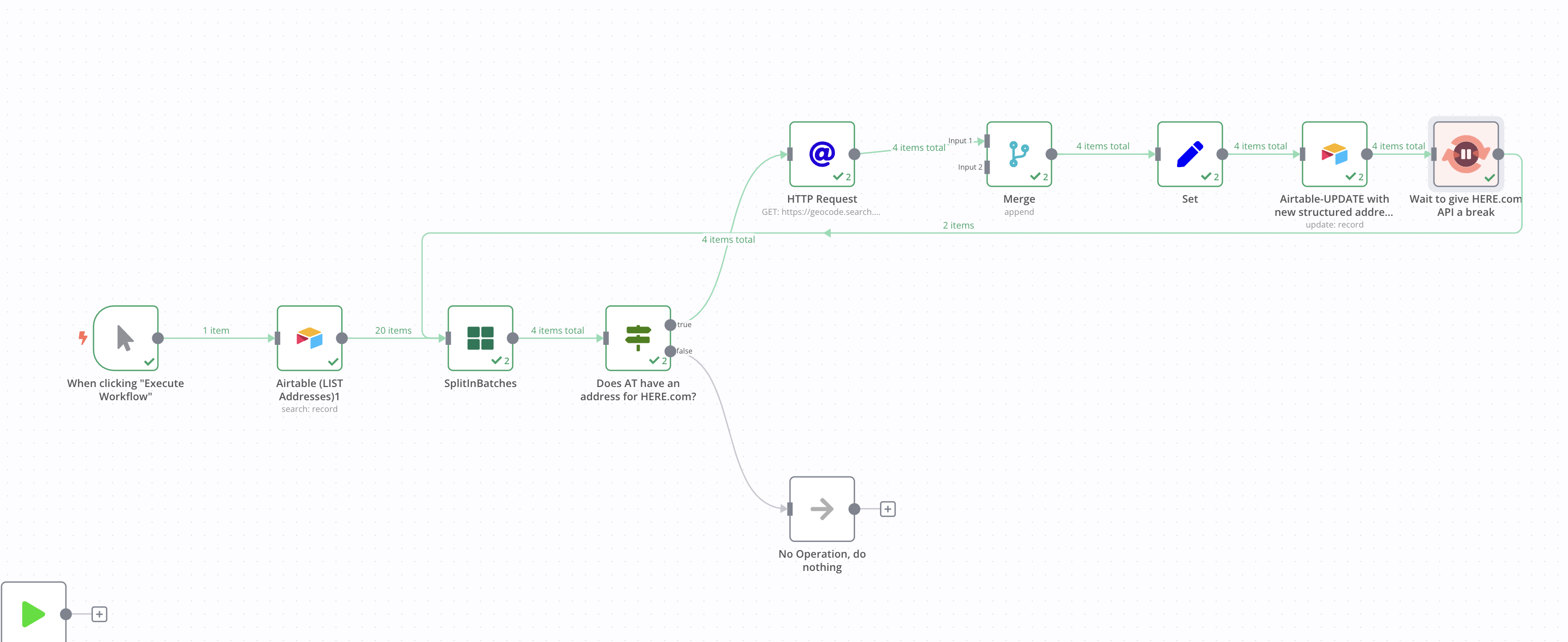

I’m having exactly the same issue with ‘Wait’ node. I have set it to continue after only 1 min and all it does it get stuck waiting, and never comes out of it. I’ve even tried to put the Wait node in different positions in the flow but it makes no difference.
I’m on the latest stable cloud version.
UPDATE: I’ve noticed has resumed, but its taking much longer than 1 min… probably more like 3-4 mins, even though only 1 min is set.
UPDATE 2: I think I’ve realised what the issue is with n8n cloud, is that the n8n workflow Editor when executed is not updating in real time so it even though the Wait is set for 1 min, behind the scenes it is actually working and waiting 1 min before continuing, but visually watching the Workflow in Editor mode it looks like the Wait is stuck in a constant cycle for about 3 to 4 times the amount of time, and then the flow suddenly updates itself (this is the situation of following a Batch process after the Wait).

Hi @spessex :wave: If you could provide it here in JSON format with no sensitive data, that would be great! If it does contain sensitive data, can you DM me? It looks like your wait node comes after an Airtable node, I can try sending on some of the sample data over to my own Airtable instance and see if I can reproduce this.
Have sent DM. struggling to send code as there’s too many characters for this messaging platform. Is there a way to send the actual JSON file?
Messaged you back with some options :slight_smile:
Your workflow requires credentials that I wouldn’t have, but after trying to mess around a bit more with Airtable and a wait node, I still can’t see this behaviour with an execution :thinking: Would you have some test data that you might be able to share (that doesn’t require credentials or have sensitive information) that I could maybe try and test with?
