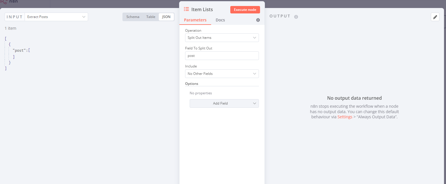

It stops at the extract field, and as I have little knowledge yet, I didn’t see what else to do.

What is the data the html request node is outputting? It looks the html extract is not using a selector it can find and it might be set to always output data as well under the node settings.
In your screenshot of the ‘item lists’ node, you’re splitting out the post data into items but there is no post data. So n8n stops in this case.
If you need n8n to continue you can click the settings cog under the ‘execute node’ button and turn on ‘always output data’.
