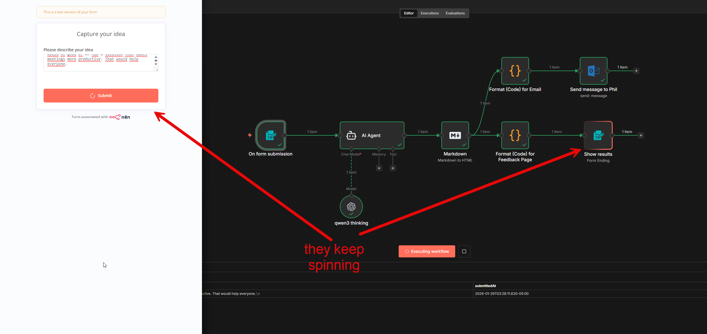

Hey,
I have a workflow that contains an input form, where I simply capture some text, which then gets processed and formatted through an AI Agent node. I have a form ending node that should simply display the structured and formatted html content from prior nodes.
It seemed to be working until last week, now all of a sudden, the form node runs forever (spinning) and never fnishes. The workflow itself finishes (because I Have set the “limit execution time” to 0.50 minutes). But the form ending node keeps spinning and spinning and spinning.

Yes, I have created a very simple example workflow, uploaded to this post.
My workflow 779.json (3.7 KB)
Hey @inservo I have tested the workflow with my credentials and it works really well as i have expected it to, it asks the user about the idea evaluates it and then shares the output in the ending and shows the MarkDown→HTML output in the ending, what is causing you the problem exactly in your main workflow?
Thank you for your very quick response.
I basically found one difference I had, however, it is still not working.
I exchanged the form ending node for a “next form page” node because what i basically want to do is to go through some iterations and with the help of AI improve the response until is good enough to be submitted.
Not in the workflow I shared (very simple one) but in general, that is the idea.
However, no matter if I choose form ending page or next form page, it never renders and never stops spinning. Does that basically mean you cannot use AI thinking models inbetween form pages as they have dynamic thinking times (that would be quite disappointing and unlogical from my point of view)?
My problem is that it never shows the HTML output and keeps the Form Ending node spinning, never rendering anything. It stays “stuck” on the submission page.
When i have tried it without changing anything in the flow it shows me the HTML as is when the AI finishes generating the output, and works just fine as you want it to be, have you tried switching to a different mode? or using Webhooks instead of forms?
