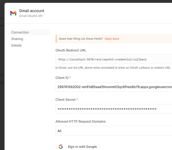

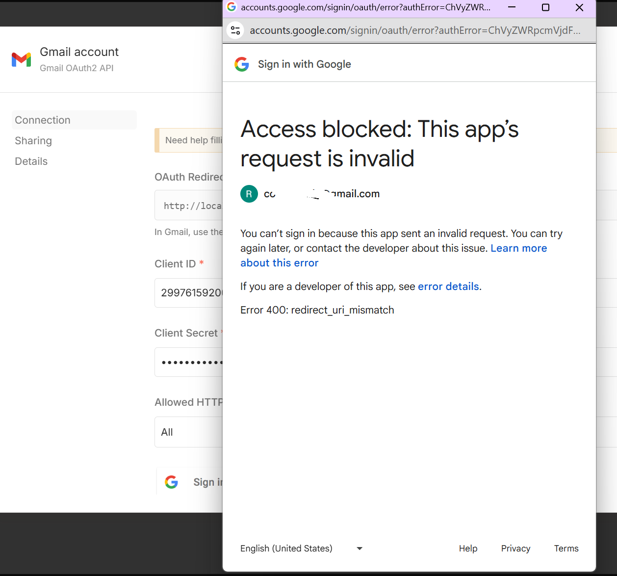

I am using the gmail send send a message flow. I have selected Credential to connect → From the drop box, selected Create New Credential. Then I have created client id and secret key and pressed ‘Sign In with Google’ where the error saying Error 400: redirect_uri_mismatch
Here I am have redirect url as http://localhost:5678/rest/oauth2-credential/callback which I copied for later use.

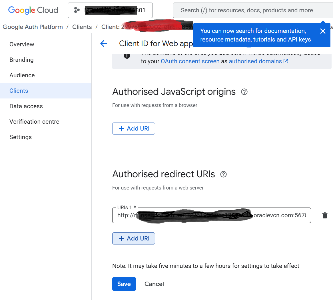

But when I create the credential in https://console.cloud.google.com/ in the redirect URL box I was unable to give this redirect url because I am not using the localhost
My n8n workflow launched from oracle cloud free tier Ubuntu system. I have the public IP address from which I am running the n8n, but the same public IP address if I give in google console → redirect URL it is not accepting and it is asking for the domain name. I have copied the Fully qualified domain name from the oracle cloud and successfully created the Cliend ID and Secret Key.
So, I have configured Fully qualified domain name (not the ip addresss) in the google console, but in the n8n it is showing the redirect url as localhost like http://localhost:5678/rest/oauth2-credential/callback,
Hence when I press the ‘SignIn with Google’ the Error 400 is showing.
Not sure where / how to fix this redirect issue.
