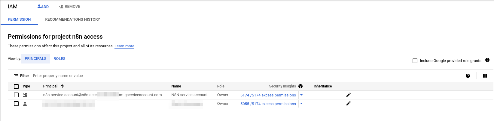

In the IAM section I have this

Hi @Pierric,
Yeah for an individual account you don’t need a service account. All I did was make a new project in Google, Setup the Oauth web application, Added a test user and added the API services I needed.
When you go to the IAM part, do you also see something like “5055/5174
excess permissions” in the security insights column? or did I do something wrong with the API scopes?
Nothing like that on mine, I didn’t touch anything in IAM.
