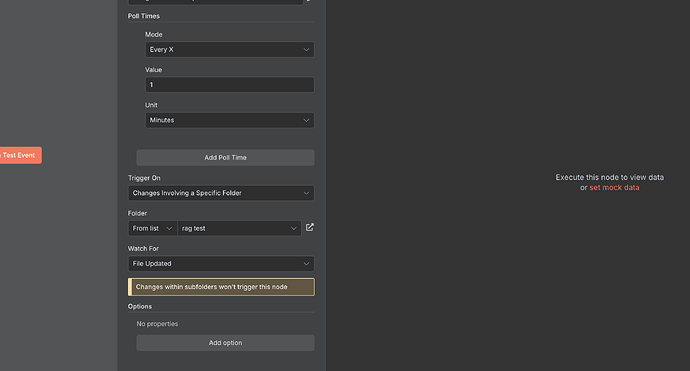

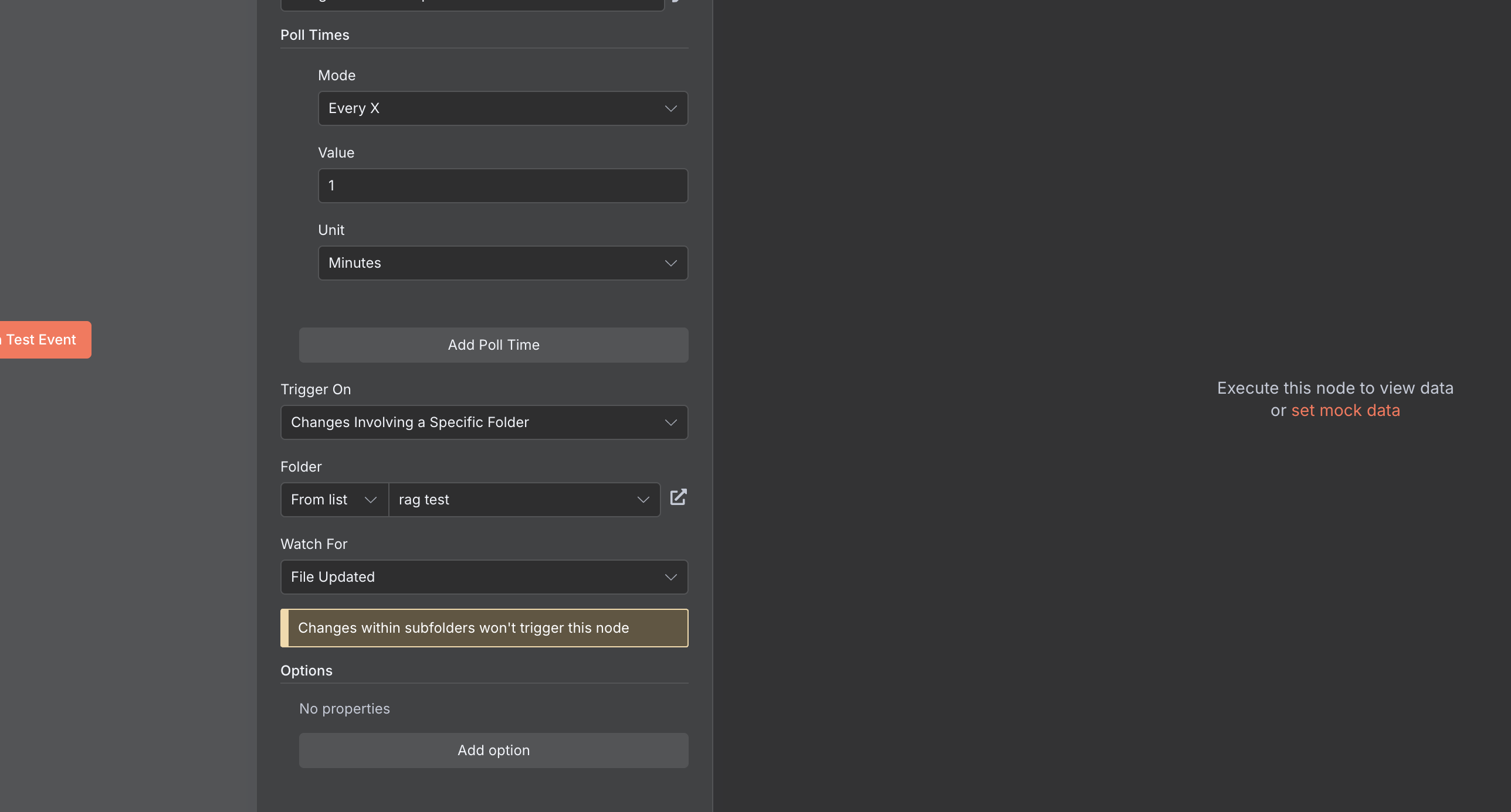

Hi, So i have a workflow starting with the node Google Drive Trigger every minutes and I test every “Watch for”. Even if my workflow is active and everything is OK, It doesnt run it when i put a files into my folder. I saw a lot of comments like this one so maybe you already have the solution for me.

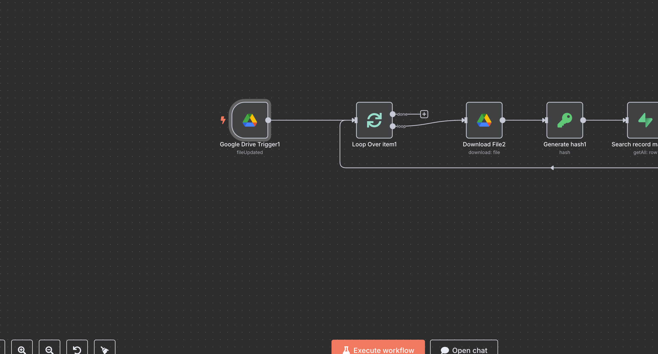

I will put my workflow here and tell me if you see something wrong with it or is it a bug in the system.

Correct me if I’m wrong but if you want the trigger to activate when a file is uploaded shouldn’t you use ‘Folder Updated’ instead of ‘File Updated’?
When using ‘File Updated’ the workflow should trigger when changes were made to any of the files while ‘Folder Updated’ must trigger the content of the folder, including actions like files added or removed.
It work! no need to respond to my question
