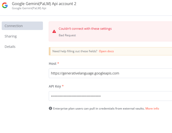

when i use google gemini node, i show bad request. how to solve the issue?
Request failed with status code 400

Hey @tytom2003 the host looks fine! Could it be an issue with the API key ? Did you test it somewhere else than n8n?
i entered api key. it show bad request.

I have same problem. The API key is worked fine. I tested with this
curl --location 'https://generativelanguage.googleapis.com/v1beta/models/gemini-2.0-flash:generateContent?key=zzzz' \
--header 'Content-Type: application/json' \
--data '{"contents": [{"parts":[{"text": "Write a story about a magic backpack."}]    }]   }'
Tested my api key with your curl and its working but have the same problem in node:
“status”: “Error”,
“message”: “Bad Request”
The error is also very plain and i dont understand where to dig
As i read docs there is point to use Google ai studio key in node:
Google Gemini Chat Model ( Google Gemini(PaLM) credentials)
May be we need to use other type of api key? or more likely some code in node is broken or maybe crenedtials apply wrong way

Same problem, the API key is fine
After the update to 1.9.53, the credencial screen do not connect to api anymore. Api key checked many times!
Had this same issue. Found out that it was because im self-hosting it on Hetzner (with server location in Europe) and Google is blocking the ip.
Two solutions to try:
  1. Move server to US vps.
  2. Use OpenRouter (Easiest and fast)
