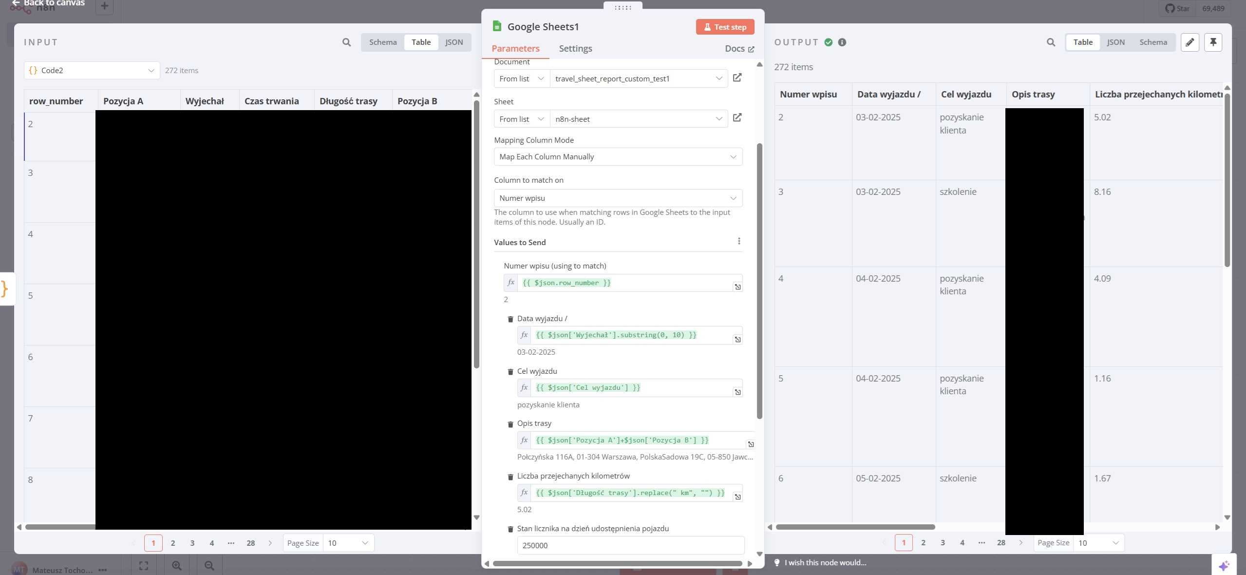

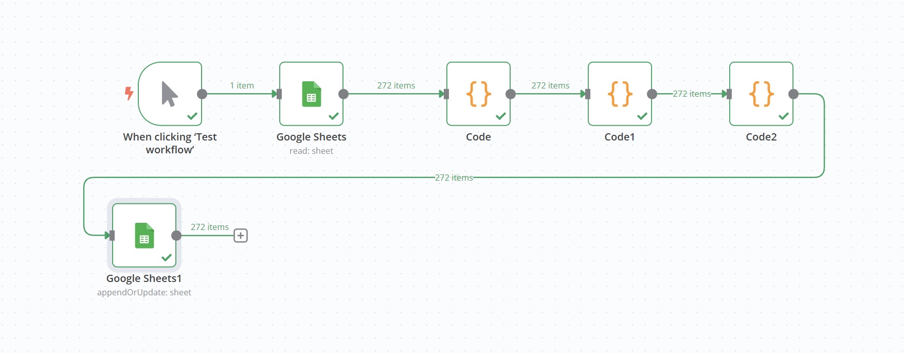

@Olek I have posted the workflow as per your instructions. Removed the google sheet link.
n8n replaced the existing row for both ‘append’ and ‘append or update’ flow. I checked with Airtable and all the records were inserted on a new row. So, its related to n8n that when I try to add the records, it does not add all in new rows, instead it replaces some of the records.
