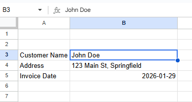

<Hi, I’m using n8n to populate an invoice in Google sheets based on a template invoice. The Google sheets node asks for the location of the Header row and the first row of data which is to be populated. This tells it where to put the invoice data and it does that very well. I also need it to populate customer name, address, and date above that. I have tried using a second Google sheets node just to populate the header but it keeps putting the info at the bottom of the invoice. I have also tried specifying the cells in the Agent system message but no luck. Any suggestions?

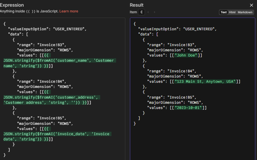

The solution I’d recommend in your case is using the Google Sheets batchUpdate endpoint,
Basically, you define the cells you want to update directly in the JSON body,

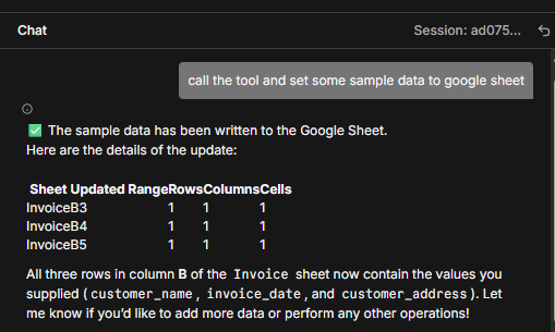

You can also use $fromAI() here, which makes things much easier for example:
Here’s the sample workflow you can start with:
