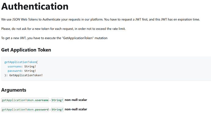

I am trying to request a JWT Token from an API:
To achieve this, I need to add the credentials in the body of the POST request.
Is there any way to realize this using the credentials offered by n8n?

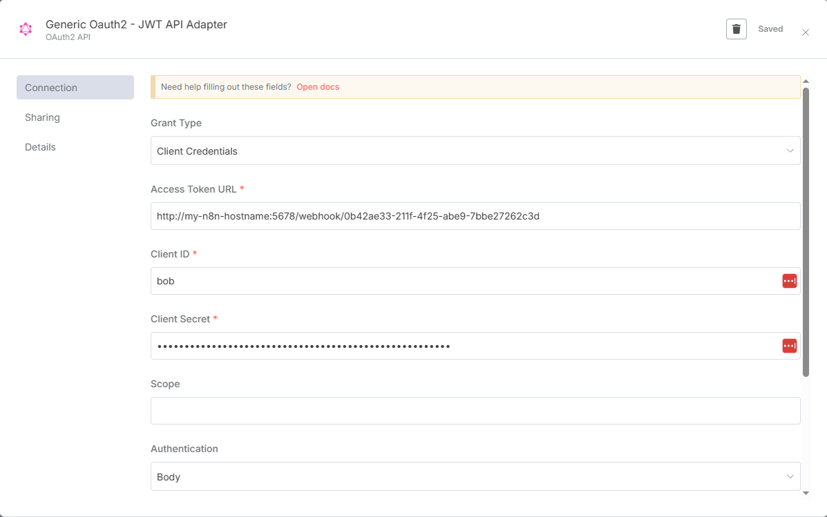

A short while after I sent that last post, I had an idea about how to make this sorta work…
I tested the idea and got it working, so if you want to try it…
Create an “Oauth2 JWT Adapter” workflow (see below) that:
  1. Accepts the Oauth2 / Grant Type Client Credentials semantics in a Webhook trigger.
  2. Sends (forwards) the client_id and client_secret values to the API JWT endpoint as username and password, respectively.
  3. Returns the JWT value the way the generic Oauth2 credential expects it.
    • Note: The API I tested already had the response in the correct form, but the Respond to Webhook node can reformat the API response, if necessary, to { "access_token": "...the-jwt-value..." }.
    • IMPORTANT: Once it is working, configure this workflow to NOT save executions, so the password and/or JWT values won’t get “logged.”
Use the “Oauth2 JWT Adapter” workflow
On the HTTP Request node, where you call your actual JWT protected API endpoint, use an Oauth2 credential (which hides/separates the secret password) and configure it to call the “Oauth2 JWT Adapter” workflow at its production webhook URL.
  • Note: Don’t forget to activate the “Oauth2 JWT Adapter” workflow first.
  • Note: This assumes the protected API accepts the JWT value in the form of an Authorization: Bearer ...the-jwt-value... header
The Generic Oauth2 Credential is configured like this:
