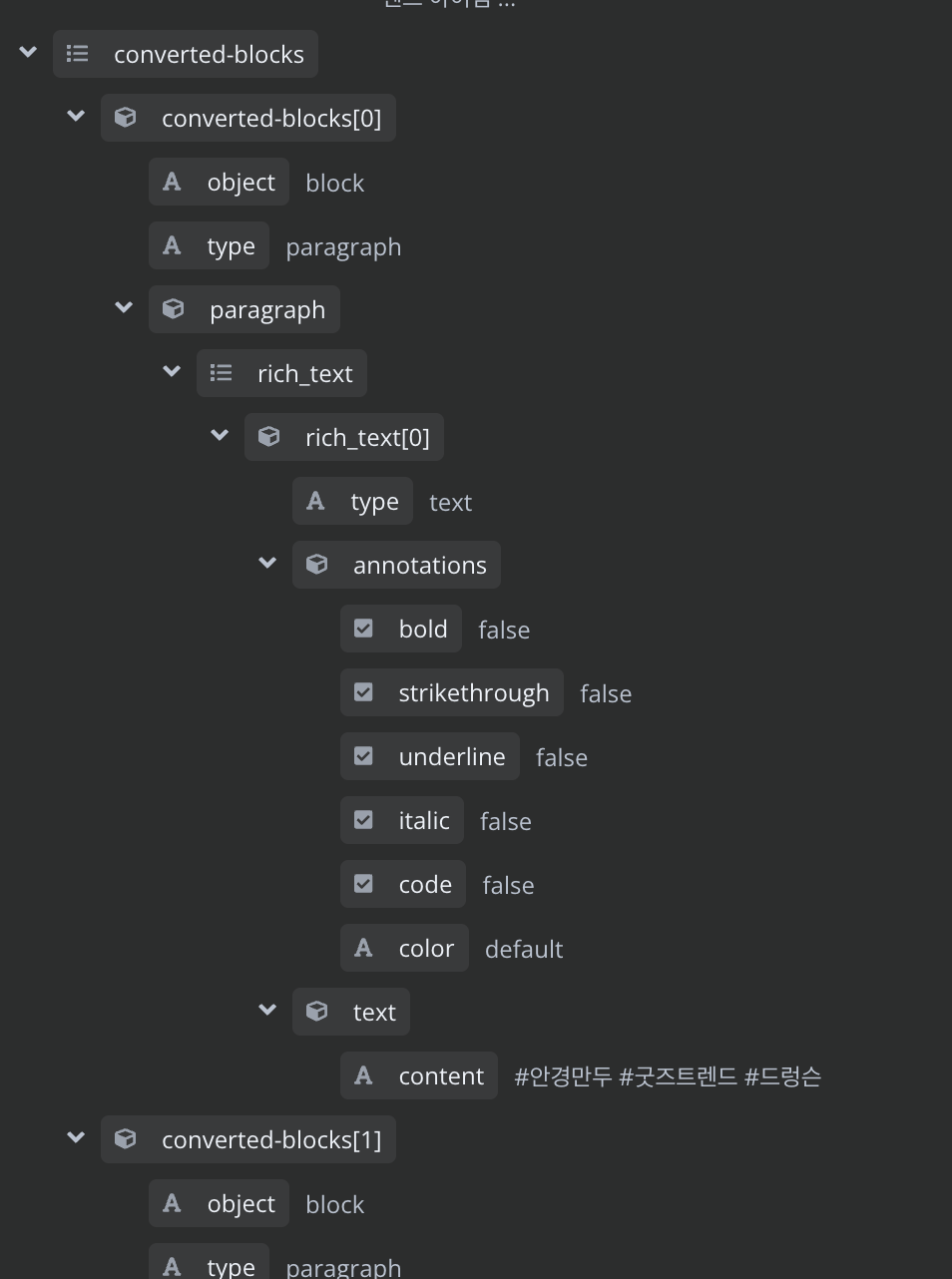

Recently, I discovered a community node called n8n-nodes-notion-markdown created by @JingerTea. After trying it out, I found that this node efficiently converts markdown into JSON format compatible with Notion.
The problem I am facing is figuring out how to implement the process of saving this JSON-formatted result as blocks in the body of a Notion page.

Here’s the resulting JSON after formatting the notions in the markdown.
(I wanted to post it as code, but got stuck on the character limit).
‘converted-markdown’ is the result output of the notion formatting.

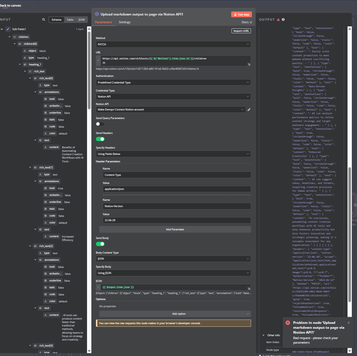

I can’t thank you enough for this valuable resource. I’m trying to implement the Notion API workflow, but I’m currently experiencing an issue with the Patch HTTP request node. When attempting to upload markdown output to a Notion page, I keep receiving the following error:
Problem in node 'Upload markdown output to page via Notion API1'
I’m using a self-hosted instance on Heroku running version 1.66.0. Could anyone please confirm if this workflow is still functional with the current Notion API? Or am I potentially missing something in my configuration?
Any guidance would be greatly appreciated!:pray::heart:.
Hi @kdventures
it looks like you got some unwanted characters in your URL field
Also, I would recommend to update your n8n version. 1.66 is pretty old by now :wink:
The character got in there while I was trouble shooting
I just ran it again and I got the same error

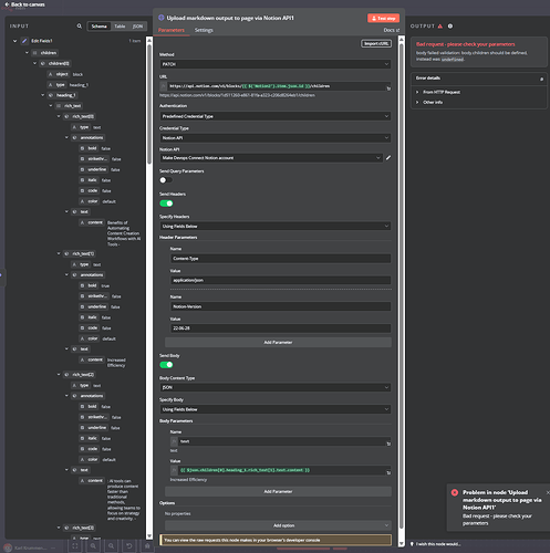

@kdventures
this is coming from the Notion API. You needs to add a children property in the body you’re sending.
