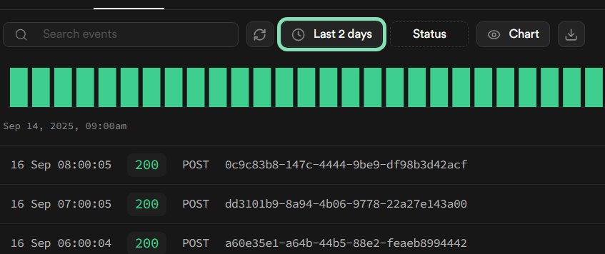

hello my friend, same is happening with me, when it sudenly stops after working without erorr loginig , since Webhook triggers not reliable after n8n restart
try to dectivate and activate the workflow, is it going to work?

I am having the same issue, did you ever find a solution?
Self hosted, I have a webhook trigger that fires on a Google Chat script. It works for about a day. I’ve noticed sometimes it responds with workflow started (but the workflow does not run) and sometimes it responds with 404 workflow not active.
If I toggle the workflow inactive and back to active it works fine (for another day or so).
@Derrick_GTC its always worth looking deeper into n8n logs, u can enable debug also and test the workflow on a seperate isolated instacne if that helps too. But I would check logs around time fails, see if its infra issue or workflow/connection issue. It could be timing out, I would also add some waits just to make sure not calling apis to much, do you see any errors when looking at past executions on the gui?
Samuel
Hello.
I am also having the same issue, did you find a solution? I also tried to create a Cron Job that calls an Edge Function in Supabase that makes an request to the n8n API to deactivated it
await axios.request({ method: "POST", url: `https://${instance}.app.n8n.cloud/api/v1/workflows/${workflowId}/deactivate`,headers: {"X-N8N-API-KEY": apiKey}});
and then activate it
await axios.request({method: "POST",url: `https://${instance}.app.n8n.cloud/api/v1/workflows/${workflowId}/activate`,headers: {"X-N8N-API-KEY": apiKey}});
But, still, after 1 day or more, unless is manually deactivated and activated, the webhooks stop working. And since the workflow stops receiving any requests, doesn’t generate any logs whatsoever.
I fix this after a long time just by updating to the last version of n8n lol
