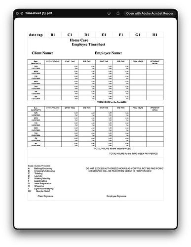

hey there, here I’m sharing a screenshot of it
please share the file directly (remove any sensitive data in it before you do so :wink: )

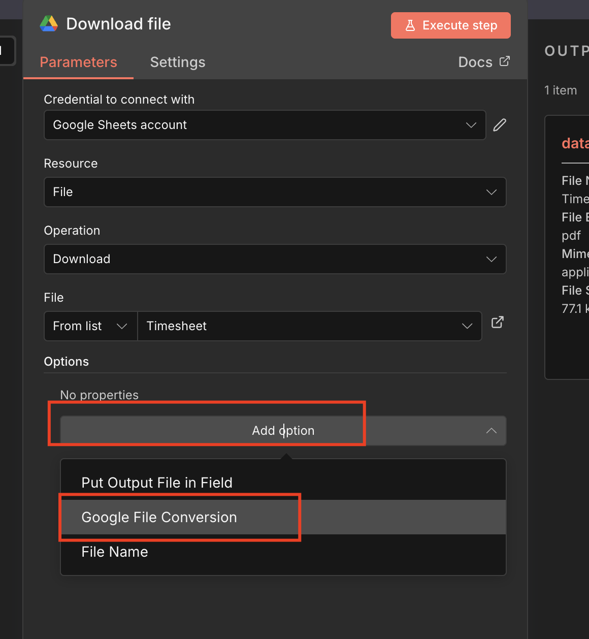

To download the sheet as a pdf, you can use the Download node for Google drive and selecting the additional option as pdf:
Of course the solution of Wouter is more efficient as I said before, also as he pointed you have to add an option in the download file node for pdf conversion.so applied to your workflow as you want to play with ai it will give this:
If you really don’t have the option in the download file node you will have to use an http node and enter the query manually.
Hope it helps, have a good day

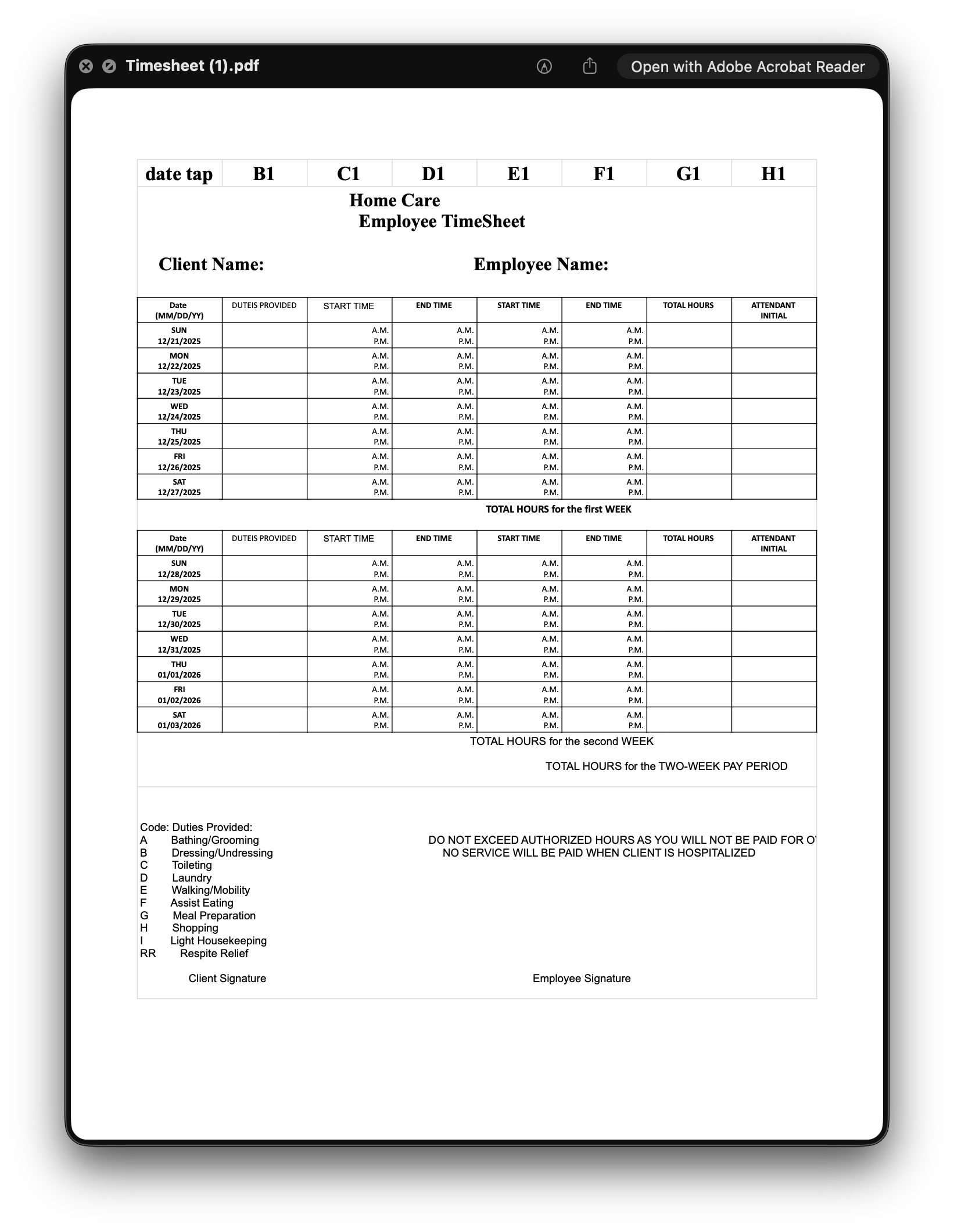

after the Update Sheet step runs, the Download / export step completes, but the file that gets downloaded/exported still contains the old dates, not the updated ones that were just written to the Google Sheet.
It looks like the export/download is happening before Google Sheets fully commits the updates, so the PDF is generated from the previous version of the sheet rather than the newly updated data, or rather it just download the exact google sheet that is saved in my google drive file.
thank you, I actually tried it with my ai agent built and I was able to see the document been download in my google drive as pdf, but it was exactly the same old document. so it wasn’t updated at all!
