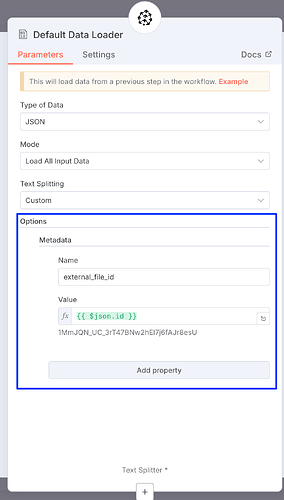

I am trying to embed text chunks with metadata (document_type and date) into a Pinecone Vector Database. I have tried using the PInecone Vector Store but with no success. How can I include the metadata in all the chunks that I embed into the database?
Can you share more about your setup, which data loader/text splitter you’re using? Are you experiencing any errors or are the vectors being upserted but no metadata is shown in the Pinecone console?
You should be able to set metadata right on the data loader node like this:
I just tested this out on my end and it’s working like this, but let me know your setup and I can try to help.

Thanks for the response. I’m using Default Data Loader and Recursive Text Splitter. Let me try out what you did and ask further questions if I have any.
