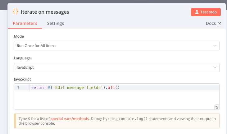

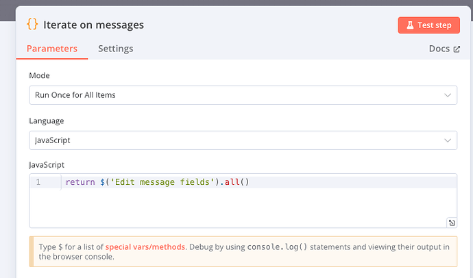

  1. I had a wrong mental model, there is no parallelization.
  2. However, the core issue I was tackling was that:
  • I fetched X (or had it as a workflow input) - read messages
  • Then I fetched Y - read labels
  • And now I wanted to iterate X (messages) again
I solved by adding a code step like this, that takes X from the previous steps, and exposes it as a result.
return $('Previous step name').all()
It is a hacky workaround for n8n seemingly unable to select which of the inputs I want to iterate on, but it works for me.
Is there a better way to do this? I expected the ‘iterate’ step to have a picker of what input I want to iterate on, but it seems to have hardcoded previous’ step’s output as its input.
