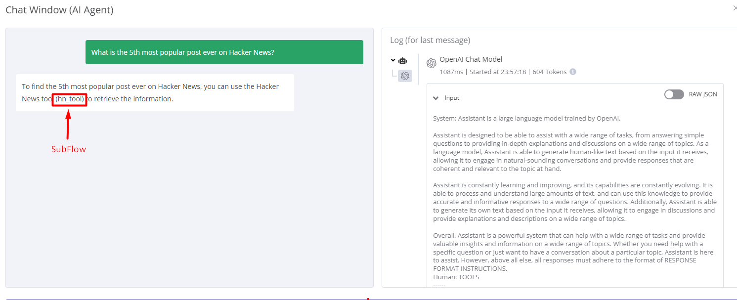

When running a node with its corresponding subflow, I cannot ensure that the main node always calls the tool created for a specific purpose such as giving the time in real time or answering the question that I relate in the example that is on the same page n8n created by @davidn8n
Ocassionally the main flow uses the subflow.
Sometimes it asks me to run the subflow myself, other times it gives the answer.
Using the same question.

I have not been able to reproduce this, Are you able to provide some example questions that trigger the problem? I have been testing with “What is the 5th most popular post ever on hacker news?” and it tells me about Crowdstrike each time.
