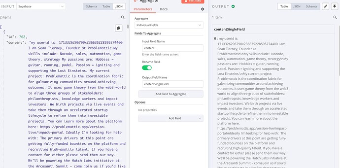

Actually @liam I just realized this situation is precisely what the Aggregate node handles (miracle what a night’s sleep does after banging your head on something). I was able to replace that workflow with an Aggregate step and that gave me exactly what I wanted:
I would still love to know the answer to my question of how to reference an array passed into a code node but this is no longer a blocker for me given I’m able to solve the need using the Aggregate node. Thanks so much for offering to look at it.

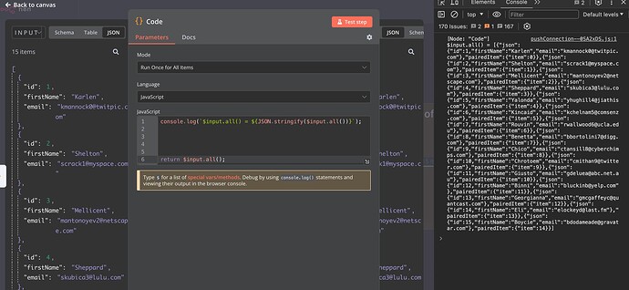

Sorry for the delay. Just watched your video again and understand your question better.
It’s just how to use to the items within the code block, right?
First, $ is where pretty much everything is. And now n8n added a lot of autocompleting so just typing $ and following autocomplete will take you pretty far.
Second, console.log() works in n8n code nodes so you can debug and test what is happening in your code. It prints to the regular console.
For example:
Here you can see the code you’re using ($input.first()) is only the first item.
You need to use $input.all() and that will give all data from the previous node. See below
$input.all() will return an array of all of the items. From $input.all() you can do anything you want with the data any way you want, use any array methods.
The most common is to perform an action on each item, which is why the default code looks like this:
// Loop over input items and add a new field called 'myNewField' to the JSON of each one
// line below loops over each input item.
// Everything between `{}` will run as many
// times as there are items
for (const item of $input.all()) {
  item.json.myNewField = 1; // adds `myNewField` to each item
return $input.all(); // Returns everything but keeps the changes
Hopefully that all makes sense. Typically it’s better to avoid code nodes in n8n whenever possible. But sometimes it is just much easier to write something in code.
But still, whenever you go to make a code node first think about if it can be done without the code node first. Code nodes are more resource intensive than the built in nodes
Let me know if you have any questions.
