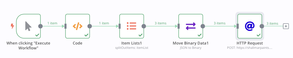

Hi @EmeraldHerald , Here is the code that I want to reproduce.

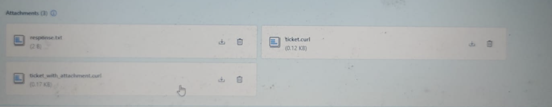

Here, I want to use Form-Data to send multiple images in one attribute of an attachment. The problem with this is that it only sends the image name, not the image’s file format.
Below is screenshot of my application , how it is visible when i am downloading the myFile.txt
The expected output should be like this:

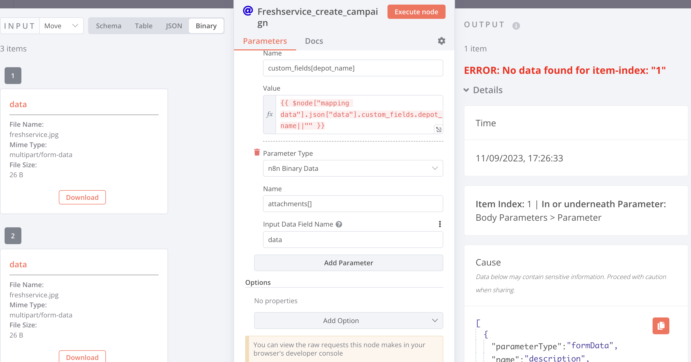

Would this be closer to what you’re looking for, or perhaps put you on the right track? :thinking: It’ll split your attachments into three separate files called data, and then try to upload the data (along with your other fields) through the HTTP request.
No, it is not operating. After adding the attachment array, the HTTP node throws the error shown below.
Hi @Farheen_I :wave: Can you try an expression like {{ $("mapping data").first(0, 0).json.data.custom_fields.depot_name }} (going by what’s in your screenshot), and seeing if that works?
Hello, @EmeraldHerald Unfortunately, it still does not work.
Can you try not using $(node), but $('mapping data') in all fields?
Yeah ! Thank you, @EmeraldHerald, it worked. You are fantastic! :giggling

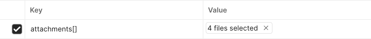

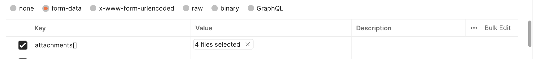

However, I am still in a bind because the attachment we send with the formdata does not update inside of a single array. Multiple tickets are created for each attachment, and each attachment is sent separately. It should proceed as follows:
You can refer to this screenshot below for more clarification of workflow. The output of HTTP node should be 1 item
Hi @Farheen_I - the HTTP node unfortunately wouldn’t support this in the way you’re looking for :see_no_evil:
A way to go about this would be to create the ticket in Freshservice previous to trying to upload an attachment (to avoid four separate tickets being created), and then update the single ticket with each attachment one by one as a workaround.
