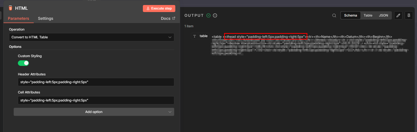

But, from what i’ve experienced, the Header Attributes Option is applied to the <thead> tag.
Does anybody know which behaviour is correct? The behaviour of my n8n instance (Version 1.121.3 ) or the behaviour explained within the manual?

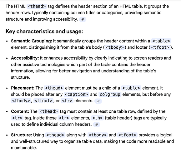

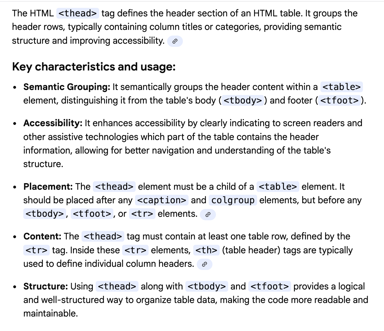

Hi @raving1522,
Yes this is the correct behaviour of setting styling to the header of a table. If you google the definition and usage of <thead> , then n8n is applying the styling to all <th> columns using the <thead> instead of duplicating the styling to each <th>

However, from a practical perspective this behaviour creates a styling limitation in real use-cases:
When the Header Attributes are applied to the <thead> element rather than to the individual <th> cells, certain CSS properties (like padding) affect the entire header row instead of each header cell.
In contrast, the Cell and Row styling options for regular table rows in n8n allow per-cell granularity — I can apply padding to each <td> and get proper spacing between cells. For the header row this is currently not possible, since padding applied via <thead> does not behave the same as padding on individual <th> elements.
Because of this, the documented behaviour (“attributes applied to the table’s headers <th>”) would actually be more consistent and more useful, as it would provide the same level of control for header cells as for normal cells.
