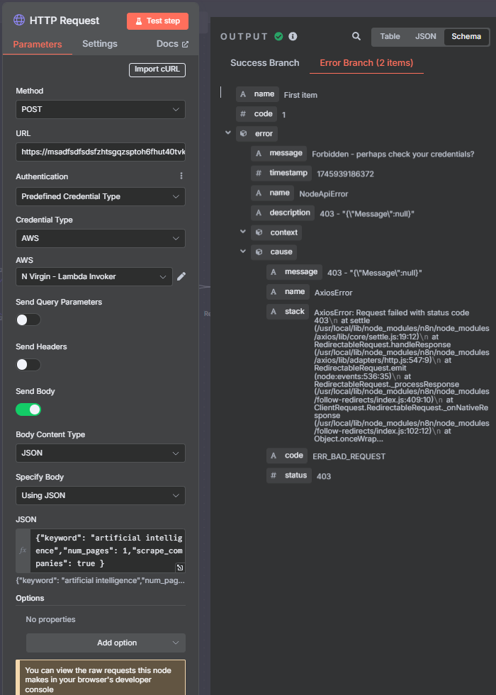

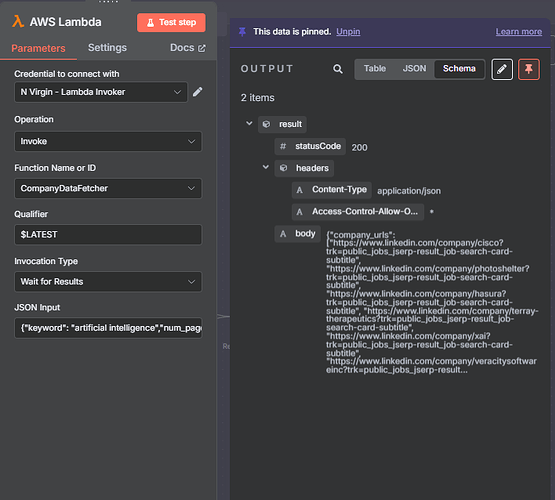

The HTTP node isn’t picking up the AWS Lambda credentials. I configured credentials by attaching a policy directly to the IAM user, generating access keys and using them in the predefined credentials. The AWS Lambda node works fine. I want to use the HTTP node because it supports batching and concurrent executions, which the Lambda node doesn’t.

message:Forbidden - perhaps check your credentials?
description:Forbidden
context:[empty object]
message:403 - “{"Message":"Forbidden"}”

I have worked with aws lambda before and I am pretty sure the url is correct. That is why it says unauthorized. The credentials also cannot be wrong as they are listing the function names correctly. I highly suspect that https node is not including the AWS predefined credentials in it.

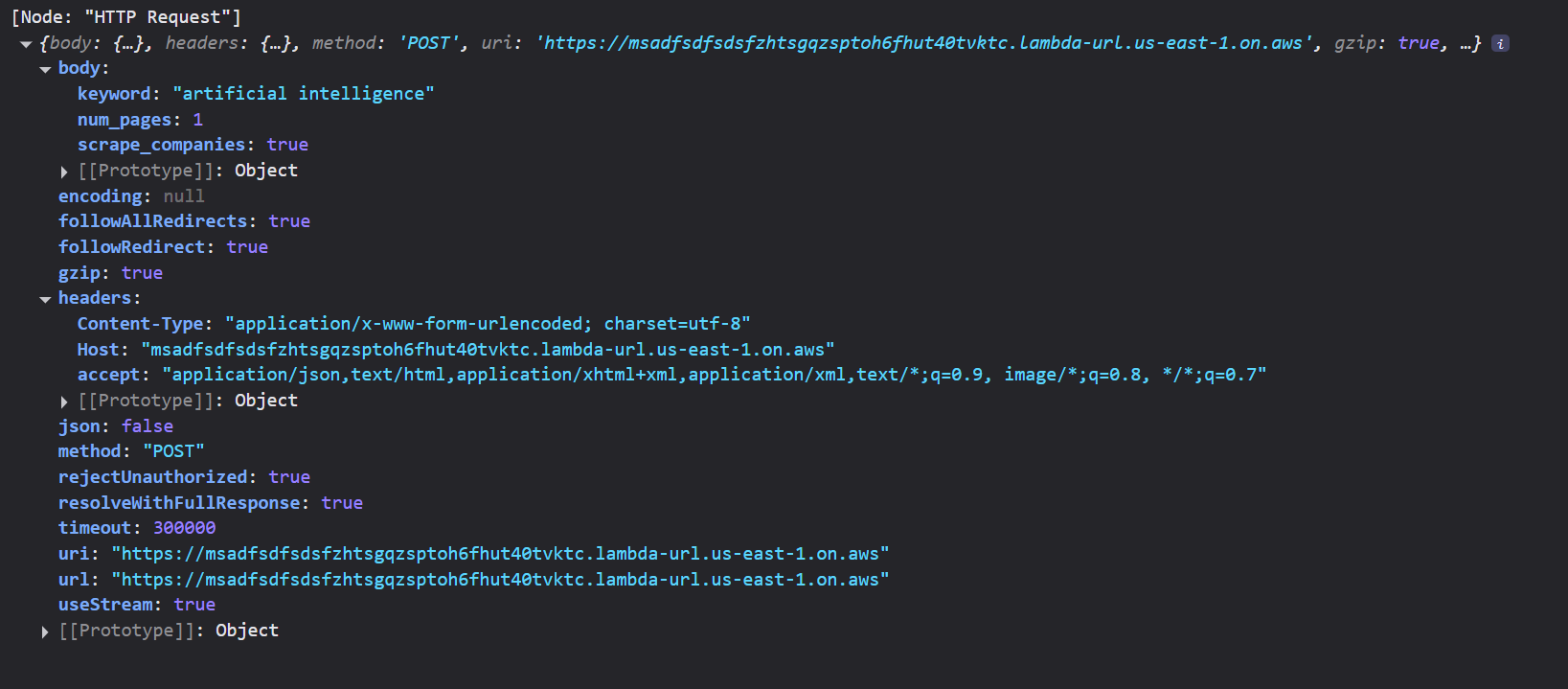

The requests have clear X-Amz-* headers which i cannot see in the https node raw request output in the console. The only other option i can think of is using subworkflows but since there could be potentially 100s of requests I really want to avoid it. Https node is quite versatile and handles everything we can think of but in this case I am unable to understand what I am doing wrong.

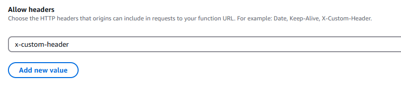

    • In the Allow headers list, add something like x-custom-header
    • The HTTP node will forward this header in each request.

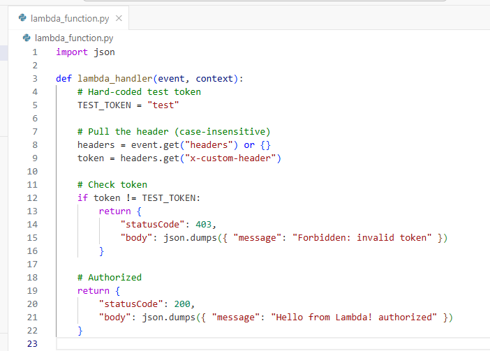

  3. Enforce your own check in Lambda, something like this
  4. HTTP node config
If someone sends the wrong header value, your Lambda will automatically return the expected 403 error
