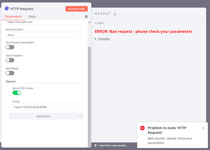

got error while setting up proxy with ip address instead of domain and non standard port.
if I set up wrong port or IP I got ERROR: The service refused the connection - perhaps it is offline
if I set up login and password like 123:321@178.234.28.84:40006 I got the same ERROR: Bad request - please check your parameters
n8n version: 0.227.1 / 0.236.0 / 1.1.1
Database (default: SQLite): SQLite / PostgreSQL
n8n EXECUTIONS_PROCESS setting (default: own, main): main
Running n8n via (Docker, npm, n8n cloud, desktop app): Docker
Operating system: Ubuntu

The issue not in the IP instead of domain:

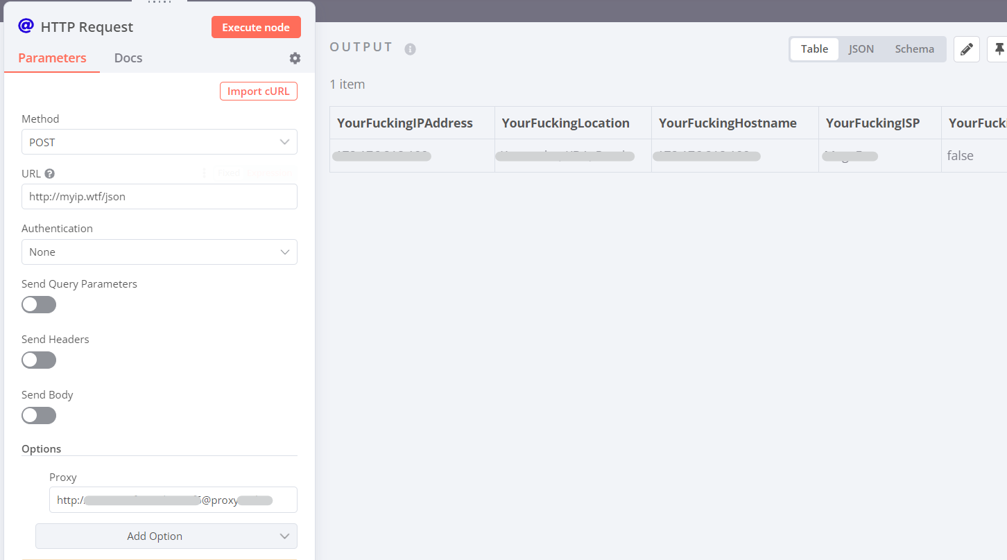

I found something - If I request page through http it works ok, if https - got error.
http - ok:
https: - error:
Tested on 0.236.0 and 1.1.1. GET/POST - doesn’t matter. Only http vs https scheme in target URL makes a difference.
n8n tries to connect to the proxy via HTTPS despite the scheme in HTTP Node > Options > Proxy setting as I can see in the traffic logs.
