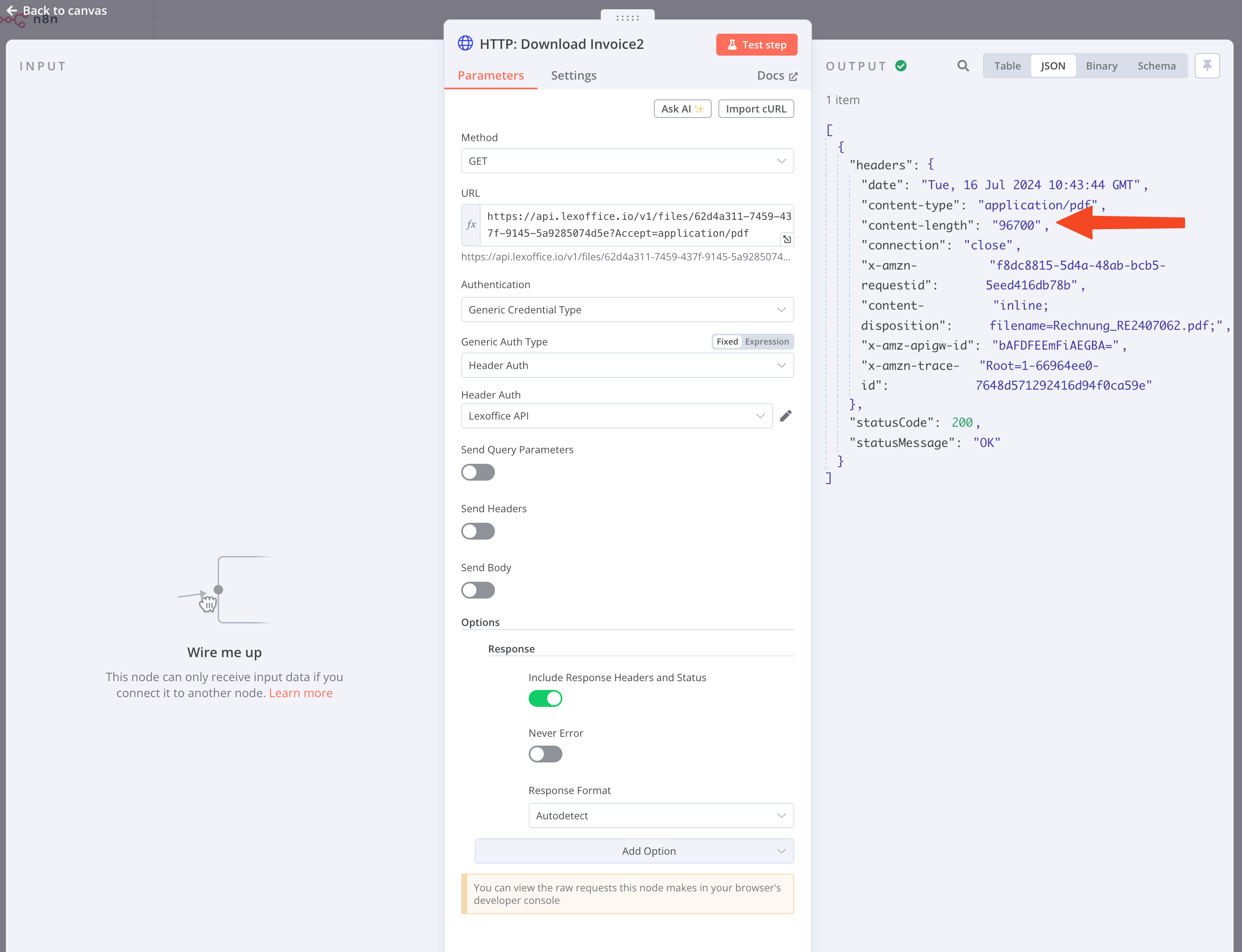

I am trying to download a PDF document (Invoice) from Lexoffice using the HTTP node.
This is the API document for reference: lexoffice API Documentation

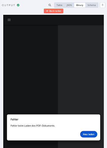

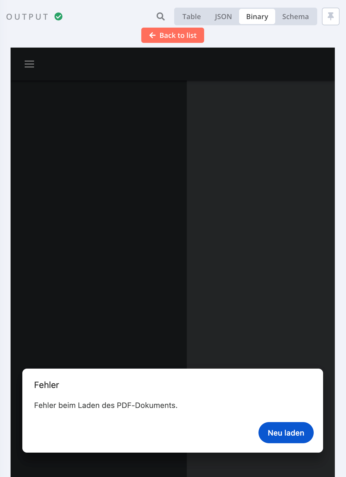

The document is downloaded and no error is displayed, but the PDF document seems to be corrupted and cannot be opened, it throws an error in the PDF viewer in n8n and in every other software as well.

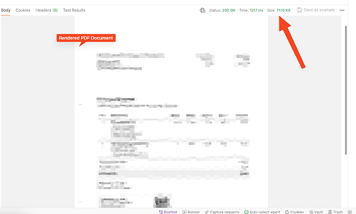

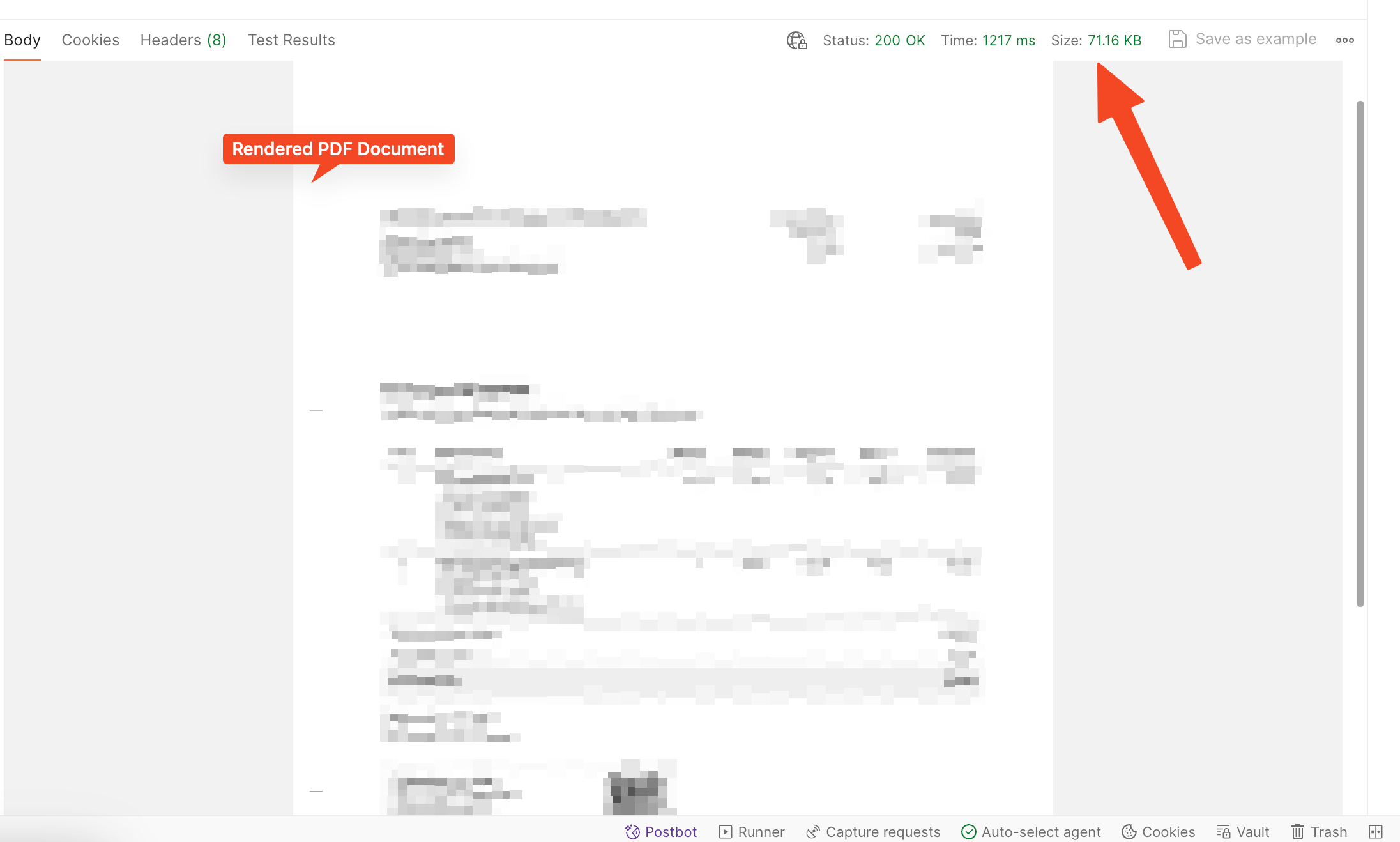

I tried the exact same request in Postman and the response returned the correct PDF document without issues.
The strange thing is that the file size of the response is different as you can see in the screenshots provided. Postman file is 71KB in size, n8n 97KB.
I never experienced that before, so i hope somebody can help out.
n8n Screenshots:
Postman Screenshots:

Since the content-length header is returned by lexoffice, and since the two values do not match, I suspect that lexoffice is returning a different file to n8n.

The strange thing is that there are no errors, HTTP Status Code 200 in both cases.
Only the Filesize and Connection have different values.
