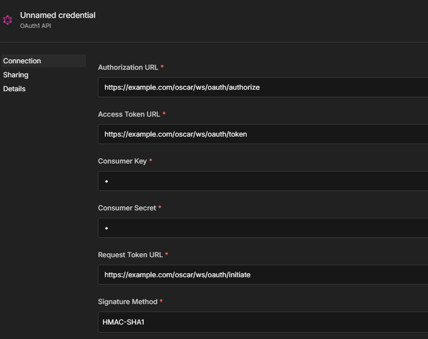

It should be straightforward, You shouldn’t need any code nodes or manual requests at all (this is most likely AI-generated advice), n8n handles authentication for you natively, You just need to fill in the credentials/URLs correctly,
I haven’t worked with this API before, but after doing some research, I found this documentation,
so if this is the API you’re using, I would configure the authentication like this:
It is also important to check the Callback URL and make sure it is registered correctly in your OSCAR application settings..
This doesn’t work. Every field is completed correctly but it doesn’t work, because during the authorizing process a webpage should come up to authorize n8n. This one doesn’t come up and that is why I get the “unauthorized error. OSCAR uses Oauth1a, which is a bit different then OAuth1. Like Tamy said above OSCAR doesn’t support the full OAuth 1.0a authorization flow required by the OAuth1 Generic credential.
TL;DR: The OAuth1 settings are correct, but OSCAR’s OAuth 1.0a flow is stateful and cookie-dependent (it requires cookies from /ws/oauth/initiate to be reused during /ws/oauth/authorize). n8n’s OAuth1 Generic is effectively stateless, so the authorization never completes and requests stay 401, even with the right URLs and HMAC-SHA1. Manual signing in a Code node won’t work either because crypto is blocked in recent n8n versions. The reliable fixes are to run an OAuth helper on the OSCAR domain (to preserve cookies) or use an external OAuth1 signer/proxy after completing OAuth once outside n8n.
