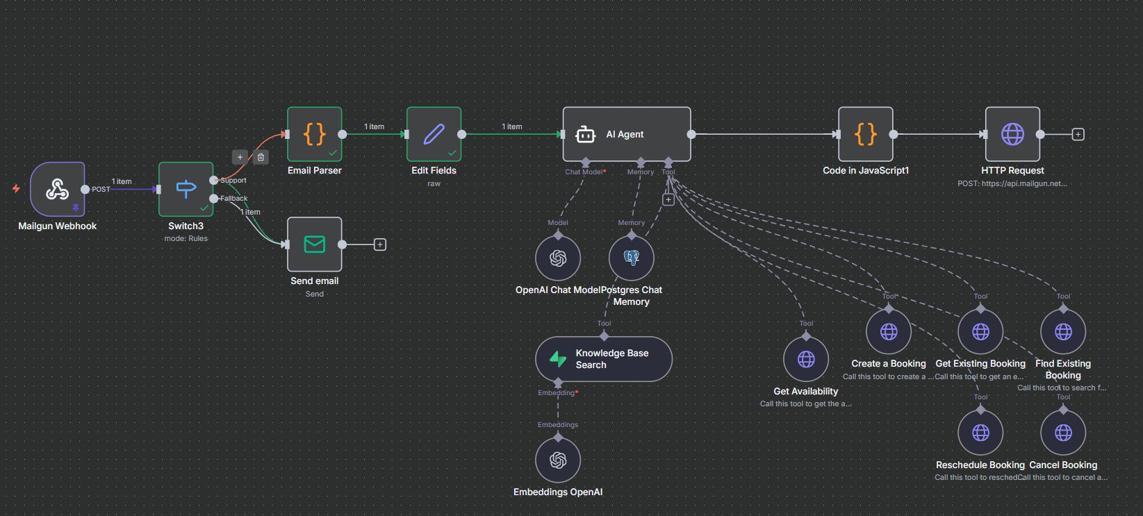

HTTPs request node doesnt work as a tool for AI Agent?
I’m so lost in trying to use HTTP Request tool/node with an AI Agent. One doc says that HTTP Request Tool Node is deprecated here. Another page says to use “HTTP Request Tool” (not the regular HTTP Request node). And one says the HTTP request node should be used here but doesnt say how, and I cant seem to connect the HTTP Request node into the tool port of the AI Agent.
So Im lost. Which tool/node do I use for my AI Agent to send a Get request to cal.com via API. Is the AI Agent node pointless in this case?? Like can we please have clear documentation, (i.e. DELETE OLD DOCS TO PREVENT CONFUSION AND OLD DEMOS) And clear examples INLINE that show how everything works.
I solved it. I was using templates which had outdate node versions. to get correct version of HTTP request tool, you have to click the plus on the agent under tool path, and select node from there.
