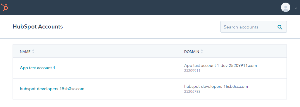

  1. Ensure I have both an app and a developer account:

  8. Clicked “Connect my account” on the n8n credentials screen. In the Hubspot pop-up, picked the App account (not the dev account):

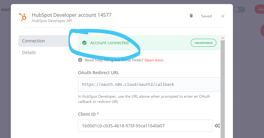

  10. Success:
So while this is super cumbersome and error-prone, the process still worked. You might want to compare step by step that you picked the right values in each field.
