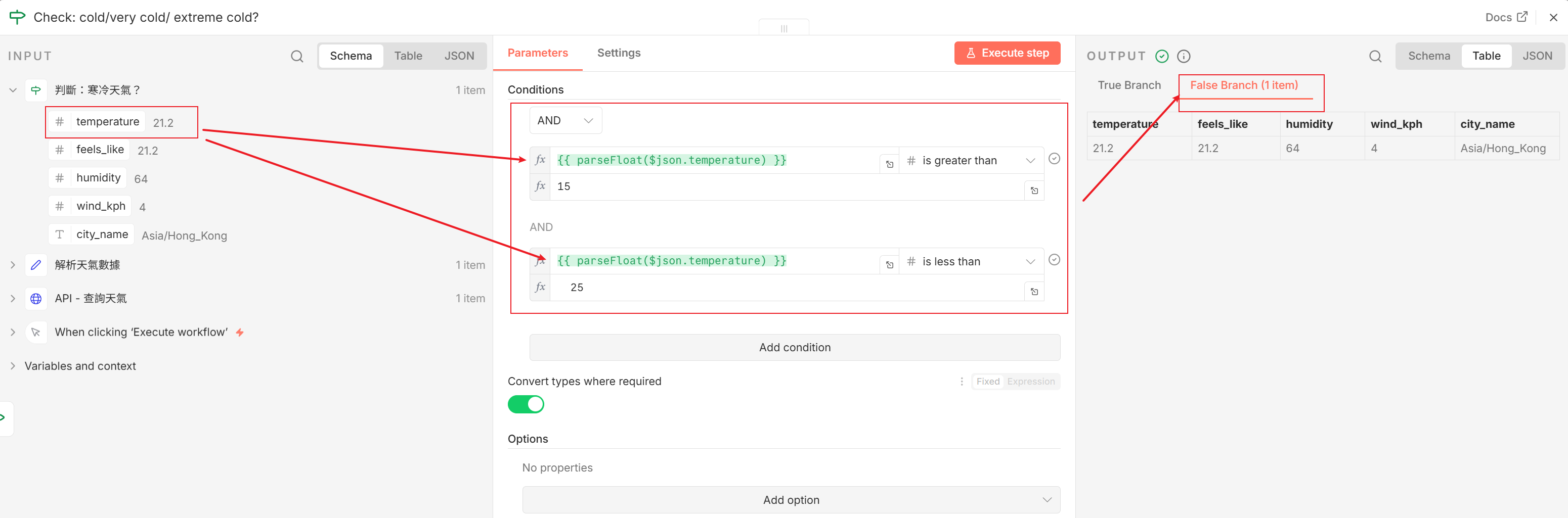

Hi ,
Can any body help me?
When I put the input temperature=21.2 to the IF node , I cannot get the TRUE output return for 15<tempterature<25 . I have already convert the temperature to numeric.
Hi ,
Make sure what you pass(number, string) and what you compare(number, string)??
I think this is the problem mainly in this node.

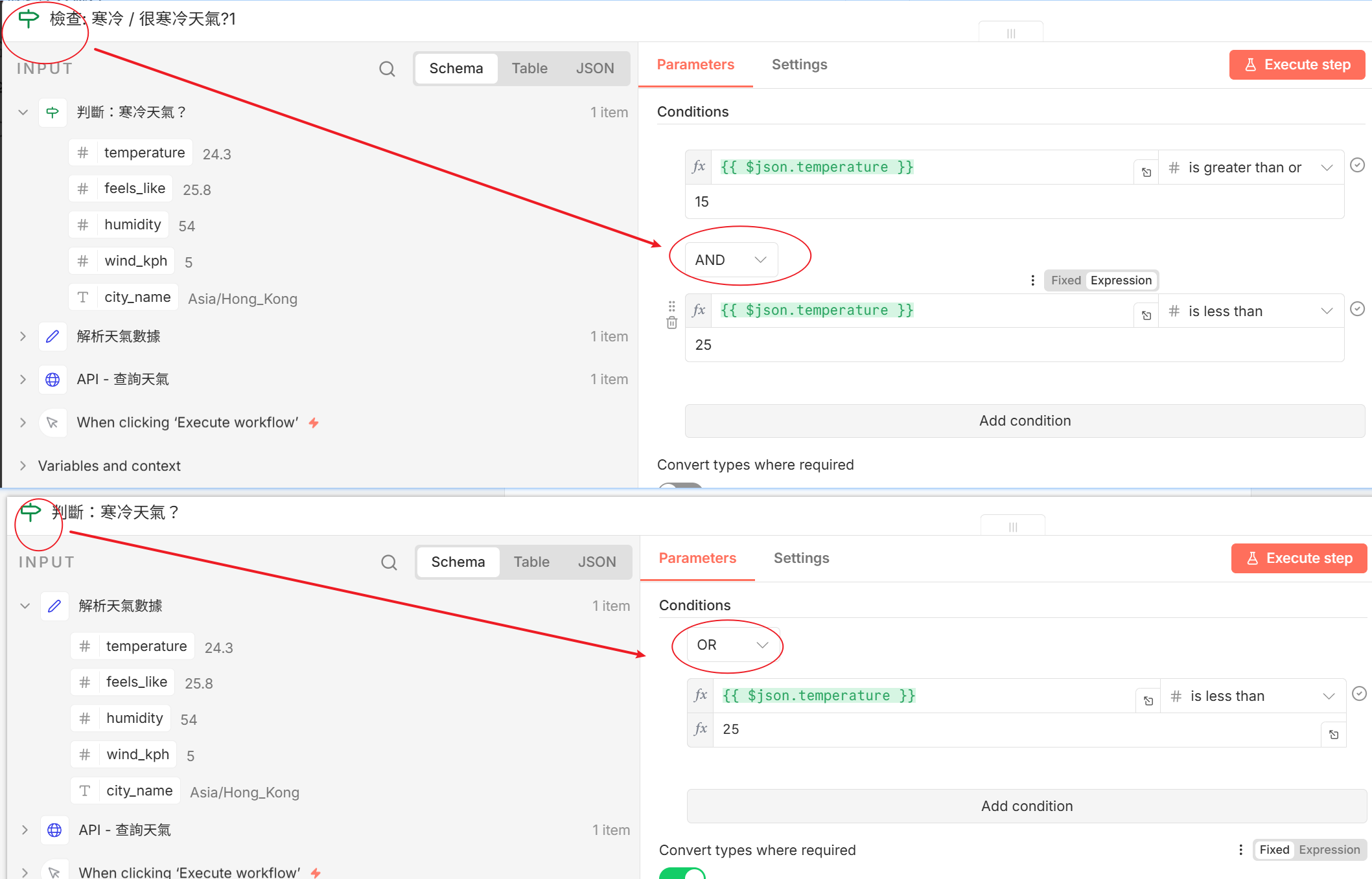

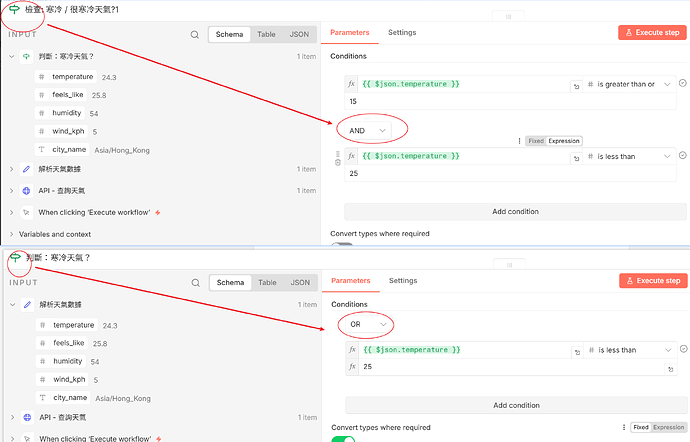

I solved the problem.
My number temperature is 21.2 which is a number already.
The problem is this workflow is generated by Claude, when I remove the “IF” node and re-Drag the “IF” node from n8n, it works now.
refer to below screen, UI is very similar, the upper one is default n8n node, the lower one is generated by Claude. but the Condition button location is different…….![]()
Not sure it is a bug or not.
