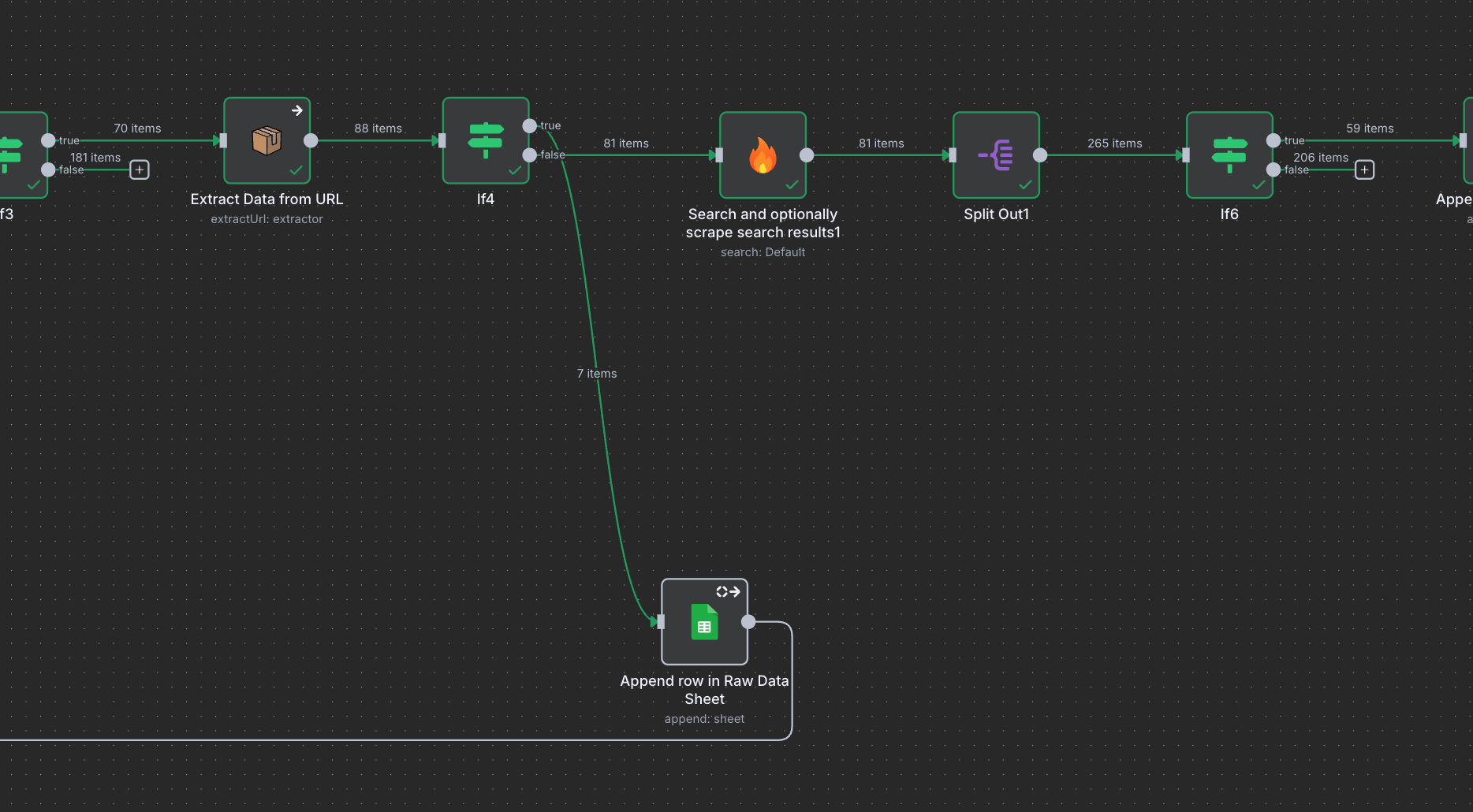

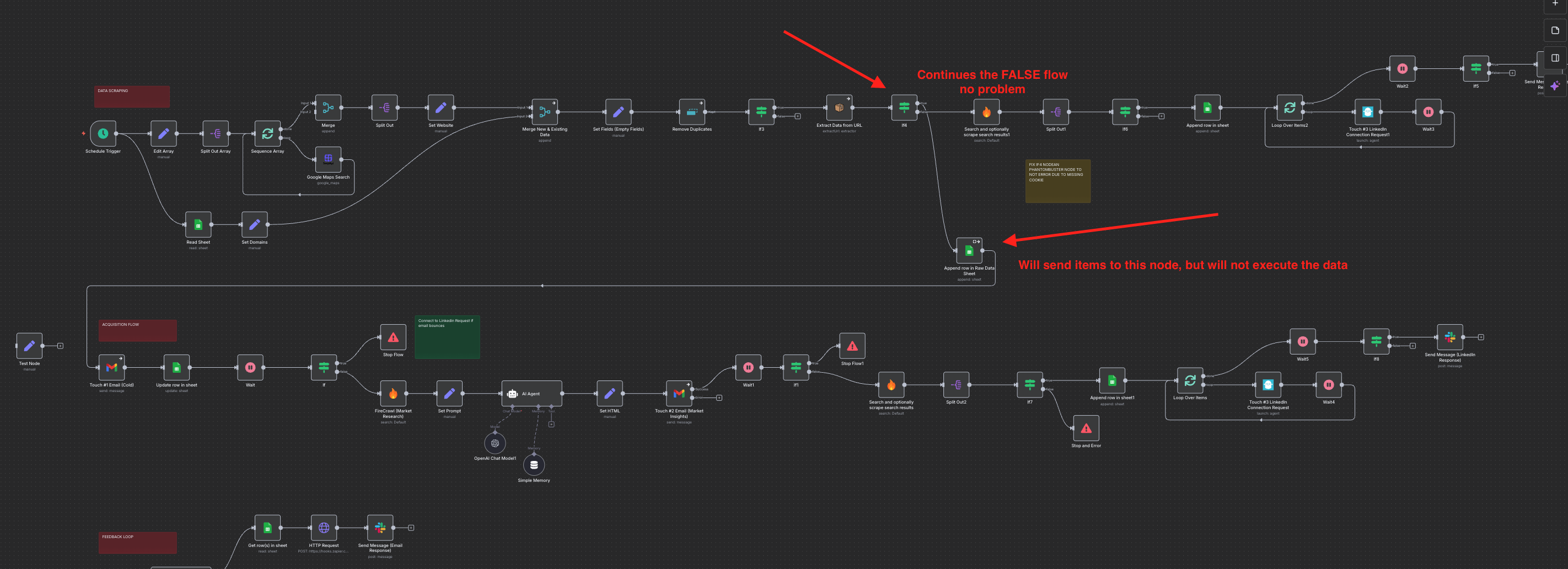

This is the node that is halting. Items are sent to the TRUTH AND FALSE branch, but only the FALSE will continue unless manually executed. I can share a test screenshot as well to show that the branch is green with items coming out of both the TRUTH AND FALSE branches.
”It will not initiate” the FALSE flow will continue and data will go to the “append Google Sheet” node, but the inputted data will not output and continue to the Touch #1 node.

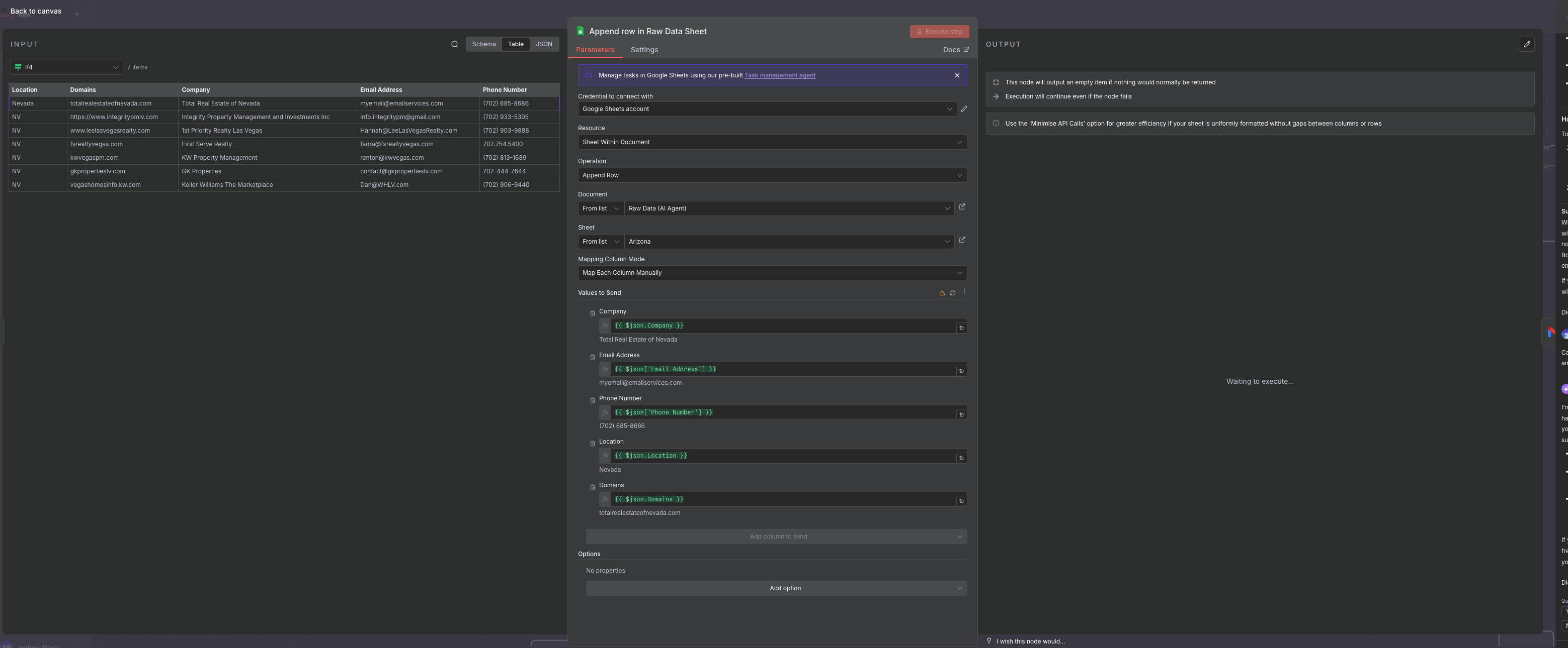

First screenshot is after the flow is executed from the beginning. Second one is the current input data for the “append row in Raw Data Sheet” node. Third is the “Loop Over Items2” node running for the false branch and you can ses that the “Append Row in Raw Data Sheet” node does not continue

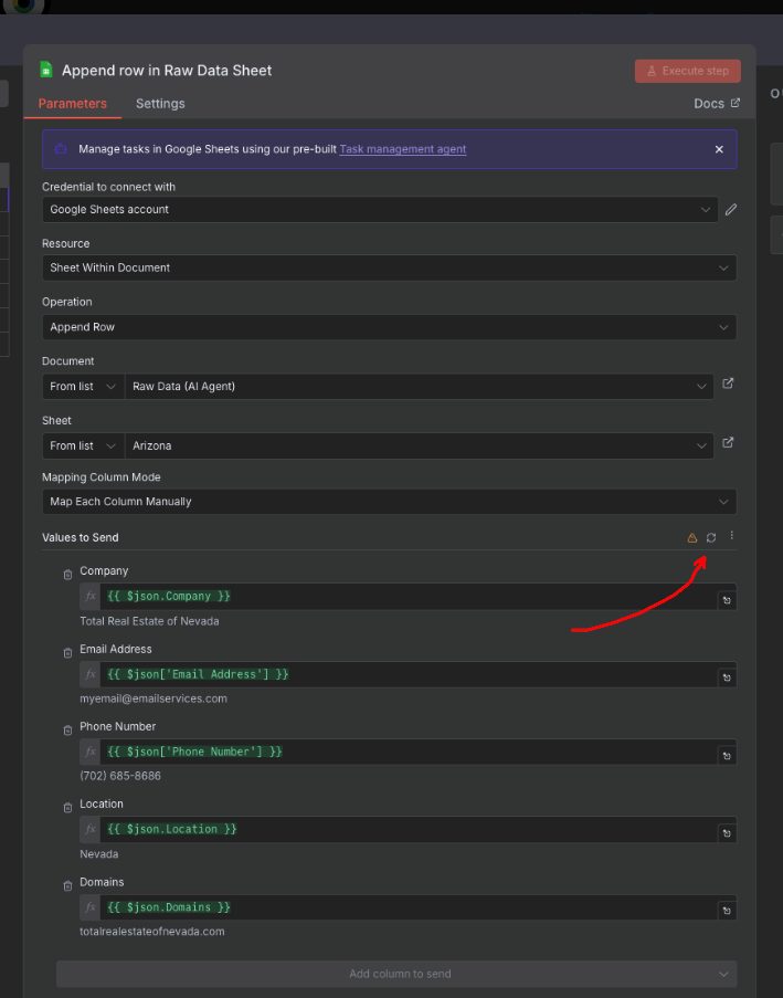

it looks like your append node is out of sync with the actual table
Click on that update button.
I clicked the update button. Running test now. Odd that it would run the node when manually executed though right?

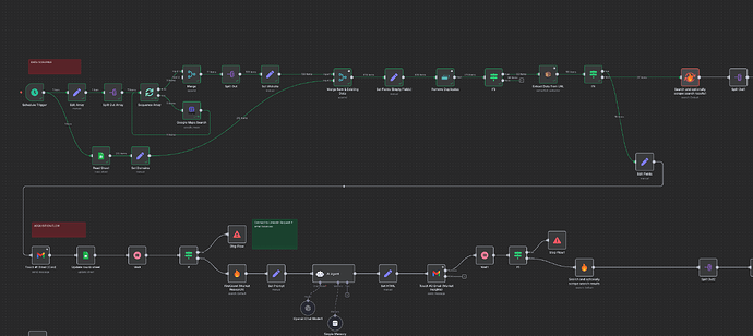

Again, I see that the scraper is running, i don’t see what happens next, difficult to troubleshoot screenshots.
The screenshot shows the the “false” branch continues its workflow, and the “true” branch from the “IF4” node goes to the “set” node, which you asked to replace the “append google sheet” node. As you see according to the green branch into the set node, it does not continue.
The first screenshot is then showing the input data going into the “set” node. You asked me to do this lol. I am simply showing you your suggestion had the same result. I also gave you the workflow code. Ask how you want this provided and you will receive it.
They way I see this working is, the IF node gets a number of inputs and splits them into “trues” and “falses”, so both true and false lines light up green. It then first proceeds with running the true branch and gets to waits for the Wait node to continue. At this point the false is not even starting.
The TRUE is the branch not running, the False is with the scraper and continues down its path.
