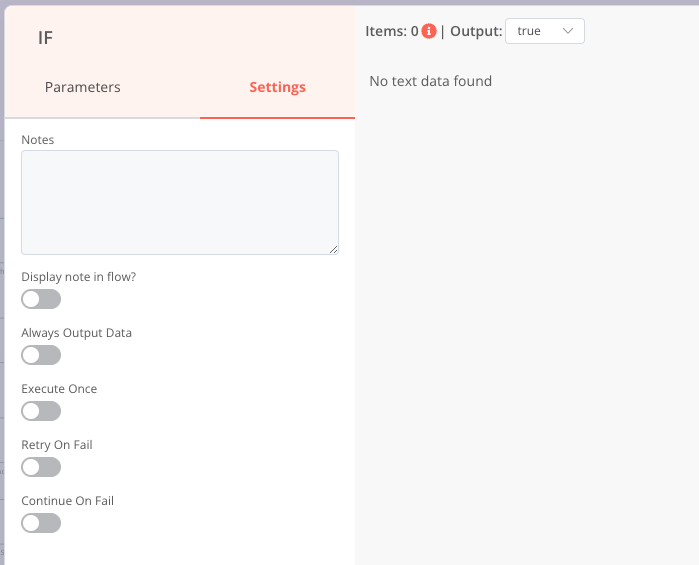

If Node execute true branch even when no true conditiion
Hi, i’ve a strange behaviour on a IF node: the true condition is clearly not reached: see the execution below:
BUT the next node (the one branched to the True condition) is executed (and fail here, because it’s missing input datas since the true condition was not reached..)
I’ve tried to rebuild the if from scratch but the error persists.
The if node is quite simple:
  • n8n version: 0.158.0 on n8n.cloud
For me it looks just fine, it return false you can see there green line with number of item
On the first and second ss you see what would happened if would be true/false (not sure but I understand it that way, if I am wrong may some1 correct me, pls)
Please try add discord node to see what really happen, e.g.
Let me know if it’s helpful
My problem is the “new skus” node (the one in red), it should not be executed.
