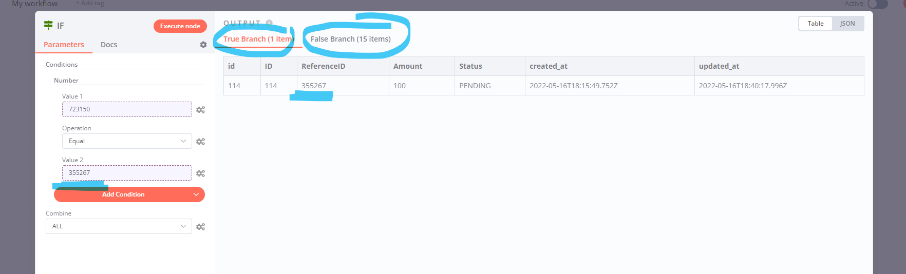

Step 5: (HERE IS THE PROBLEM)
I’m trying to filter the records using “ReferenceID” from the “Split into items” node in Value 1 in Expression. Then set the Value 2 in Expression to get the “ReferenceID” from the webhook.
You can see that there is no result in True Branch :point_down::point_down::point_down:
But when I remove the Expression in Value 2 and input just the ReferenceID.
Boom! Filter worked.
**I need to filter ReferenceID to get the record “id” which the webhook doesn’t have and I need it.

Hey @ruel.lago, the latest example you have shared wouldn’t work because your expression doesn’t return anything (it refers to a Webhook node which isn’t present in your workflow).
Though I think I might have an idea what’s going on here. Your “Split into Items1” node (btw, this could also be an Item Lists node splitting out your items - that way you don’t have to write code) returns 16 items, but a webhook would typically have a single item only.
Now what would happen on your IF node is that for the first item arriving on your IF node the expression will read the first item on your webhook node. This probably works. For the second item, your expression will read the second item on your webhook node which is most likely what fails here.
However, if you add $item(0). to your expression like {{parseInt($item(0).$node["Webhook"].json["body"]["ReferenceID"])}}, the comparison should work as expected:

By adding $item(0). the IF node successfully filtered the Value 2 like a charm :sunglasses:
