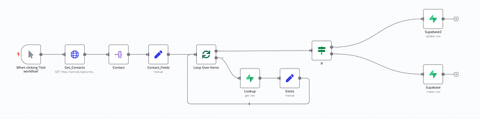

here is my not working workflow:
hope this helps you help me:)

the trick is on you look up node, Always Output Data checked, by doing this, even if the row doesn’t exists will run all the loop. then in the if out of the loop, check if the id from database item exits…
