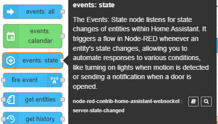

What I found is, that there is an essential feature missing:
An Trigger on which you can react to a change of a state like in NodeRed

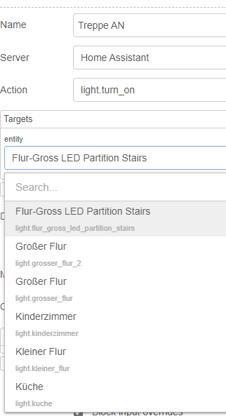

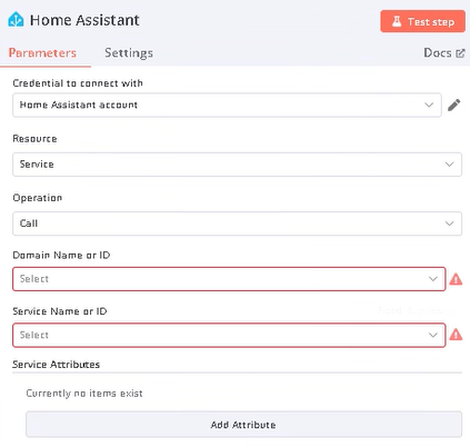

Another improvement would be, if we could get an entity list in the call service Action:
So you wouldn’t have to switch between Home Assistant (to get the entity_id) and n8n.
That’s how it looks in NodeRed:
I realy think, that many from the NodeRed Community (especially beginners) would come to n8n and contribute.

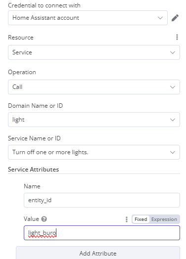

When I remember right, you can’t set a state. This definitely a bug. Workaround is to call a service instead of setting a state…
And upvote this topic :wink:
Would this be the call?
What should I include for the domain?
service
Look into your tuya entity. Which kind of device is it (light, switch, etc.) Then select the one, which is the same as your entity.
Please upvote…
Btw. This a a feature request thread and not for support. You should open a new one and we can then help you there…
