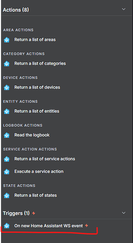

I had the same problem and implemented some nodes:
This has a trigger node for Home Assistant events and Home Assistant triggers, as well as a node for doing actions, retrieving areas, entities, devices, etc.
It also has generic nodes if you want to call something weird, or a HA plugin.

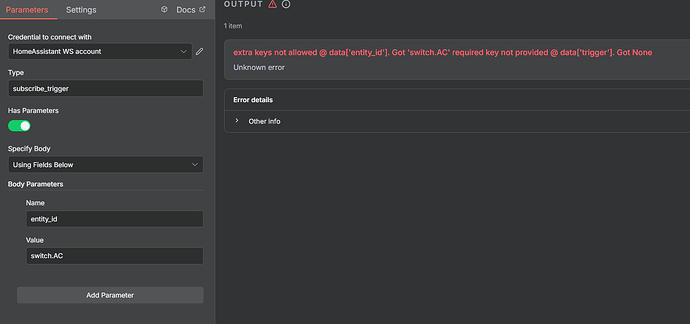

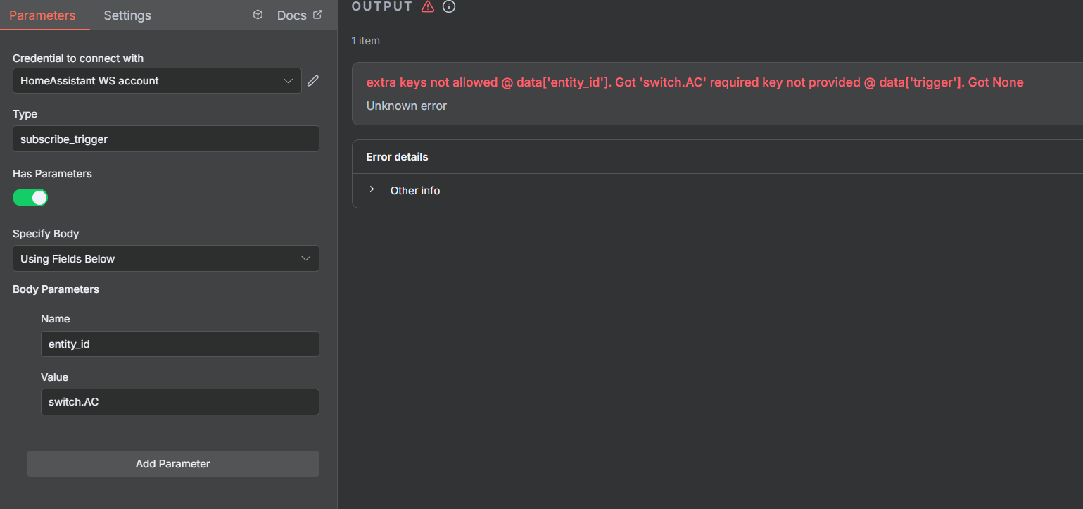

@ Simiil Hi, Could you share the trigger function sample? I try to set Specify Body by Using Fields Below and config Body Parameters but show some error:
"extra keys not allowed @ data[‘entity_id’]. Got ‘switch.AC’ required key not provided @ data[‘trigger’]. Got None
Thanks!

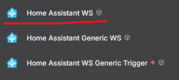

for subscribing to triggers, you’d be better off using the Home Assistant WS Trigger node, not the generic one:
There you have a bit more guidance how to subscribe to a trigger:
The Generic Trigger node is for if you want to subscribe to something that is not an event or a trigger.

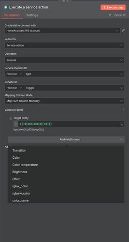

I updated the Integration.
There should be a functioning credentials test, as well as better error handling.
The Service Action node also provides the required model now:

I have self-installed n8n on docker, I can see the Homeassistant actions nodes, but not the trigger ones.
Do I have to enable them somehow?
Thanks
@HHUBSS can you share your setup? that sounds like a bug
@Kite_M The trigger nodes are not official nodes, so you have to install them. you can follow this guide: GUI installation | n8n Docs
