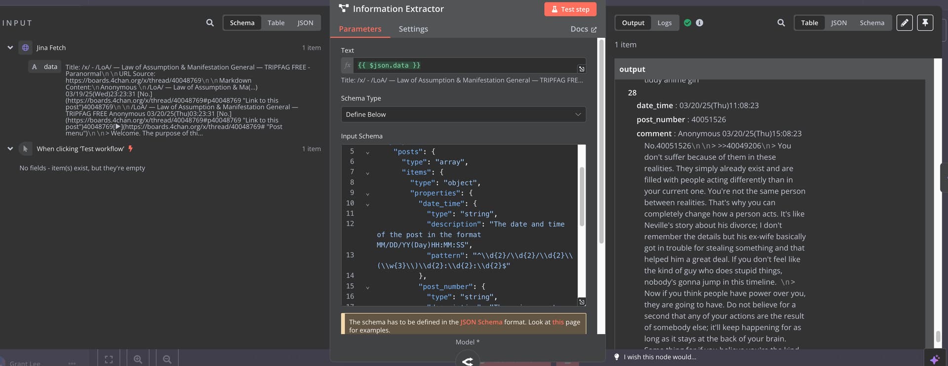

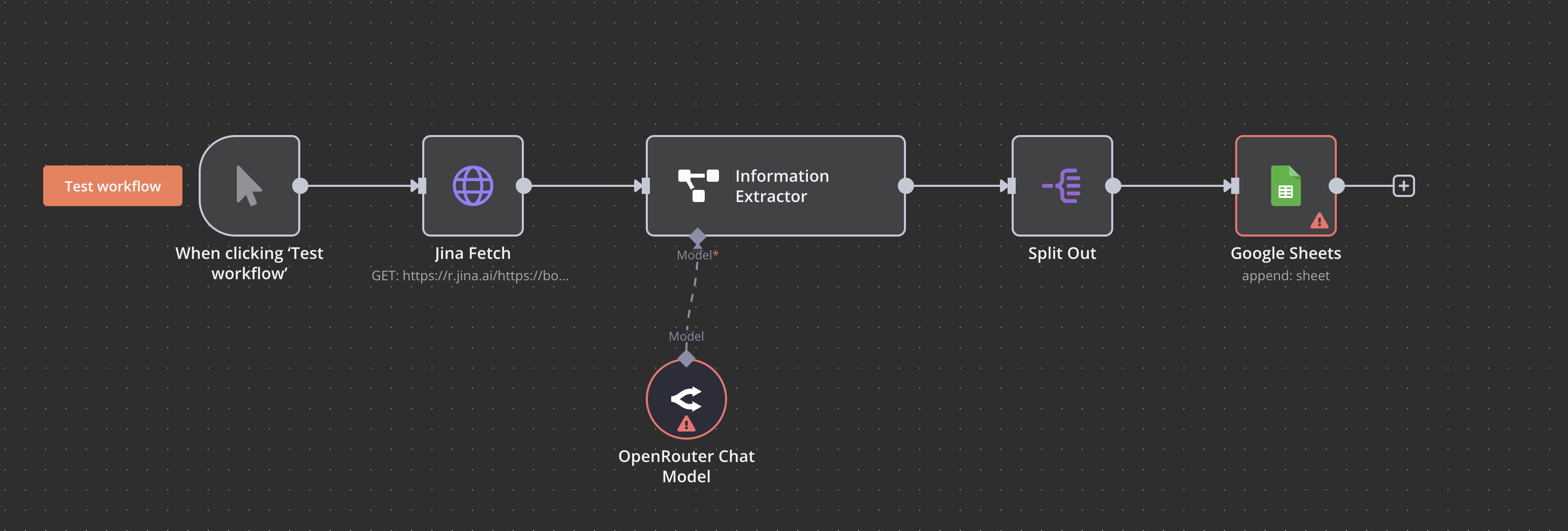

Hey ya’ll So i am web scraping using Jina AI (HTTP request node) and a information extractor node.
The Jina AI node is accurately scraping all the comments from the 4 chan thread. However, when I test the information extractor node (w/ a json schema to extract for post_number, comment, date_time) it only gives me about 28 posts in the output (the 4chan thread clearly has much more than 28 posts), can anyone help me figure why the information extractor is only getting partial of the output from the input data (only about 28 comments rather than all the comments in the data from Jina)
I am using Gemini 2.0 pro exp 02 05 (free) chat model w/ open router as my chat model

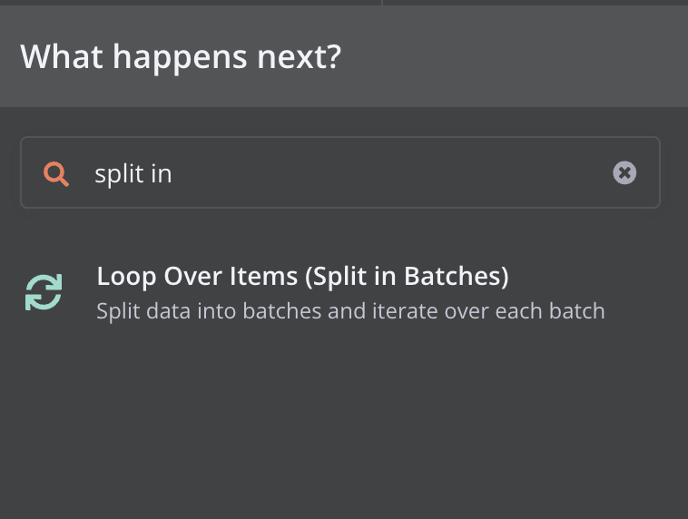

Hey Miquel_Colomer I appreciate your insightful and thoughtful recommendations. I want to try and Split In Batches node but I cannot find it in n8n, all that comes out is this Loop Node (Split in Bathces)
If this Loop Node (Split in Batches) is indeed what you are referring to in your reply, than how should I put it in my workflow to make this work?
