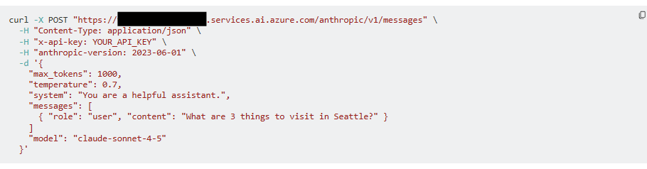

Hi all, I got this working. Add an Anthropic credential and set the baseUrl like the screenshot below. Note the connection will fail, but it will work in your flow.
Select an Anthropic Chat Model for your AI agent node as opposed to an Azure Open AI node. Choose your cred and use the “By ID” setting in the dropdown. Type your model deployment name in the text box. Execute and it should work. I only tried with API key auth, but this is working for me.

Can confirm that this does work, just connected to my Opus 4.6 and Sonnet models in Azure AI Foundry. Thanks!!!
I lied… after two weeks of using Azure anthropic claude 4.7 and sonnet 4.6 with this hack job connection, streaming broke out of nowhere and now it takes minutes for any responses. Streaming would give me a preamble in my front end, and then 2min later, data dump the response in the chatbot. Switching back to AOAI 5.4 and 5.4-mini, streaming was back and fast
